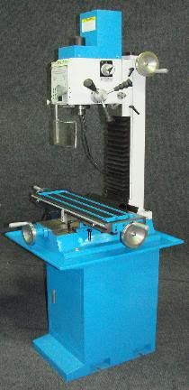

    I have a index milling machine to large about 2000 LBS or over and can not put it in my new small wood floor shop,
    so I want to buy a smaller milling machine for the new shop.
    thinking about a Grizzly one like this, If anyone can give me some advice on this it would be Great, Pros & Cons if you own one. Thank You.
    So I ordered a Milling Machine from Quality machine tools # PM-25MV
    for $ 1,295.00 it should be here on around 20 Feb. 2011
    I think it will do what I want to do in the new shop.

    Glad ya found out more on the Index. Looks like a very nice old mill. Now about the new one you ordered. I have been looking at that one also and Grizzly's which looks to me to be almost the same. I wasn't sure about the 2" spindle travel tho. PM also has a larger one coming out(of course more money). When you get this mill please post something as to what you think of it. Are you going to put power feed on it or a DRO? Keep us posted.

                        His new mill will be less than half that. They are just shy of 300lbs for the machine and less than 100 for the stand.
                        I have the PM25-MV and it's a nice mill overall with a few niggles. I have issues with the Z gib. It's not right and when I locked it using the gib locks it rocks a little no matter how tight you make the gib. And mine gets fairly tight as you approach the edges of the X travel.
                        Overall though its a good machine. I can take pretty substantial cuts in Al and with a rougher I can take pretty beefy cuts in steel as well. It will flex a bit and it's not going to outclass a 1000lb machine but it's a big step up from the mini-mills.
                          I'd find a way to accomodate the Wells Index machine. It's a quality unit. I wish I could have found one of those. I have a Webb that weighs 3,500 pounds. I have the room for it but it's sure big. I'm 6' tall and I have to stand on my toes to change collets.
                          Assuming that I had the room and the choice was between the Wells unit and anything from Grizzly, the choice would be clear for me at least.
                          Forgetting who built the machine, a 300# mill is pretty lightweight. JMO.
