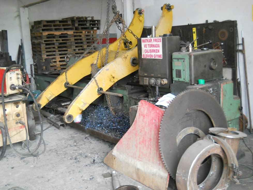

    First a couple qualifiers. This is not my shop. This was in a shop next to where some supplies were purchased.
    The loader arms are off a +/- 1 1/2 yd payloader. The lathe is a +/- 24" x 144" of eastern european descent. The loader arms are being line bored with a boring bar between centers. Obviously a lashup. Brackets bolted to the carriage are tack welded to the loader arms. An obvious application for portable line boring, but....

        Based on the size of his work do you think that is a slitting saw leaned up on the lathe!!!!
            Yes it is,
            well it's actually a high speed cutoff blade, AKA friction saw (about 30" dia & goes @ 3000 rpm , you can get them 8 ft dia ) off a pendulum saw. Used for cutting tubes .
            See HERE
            john
            John
            I used to be indecisive. Now I'm not so sure , but I'm not a complete idiot - some bits are still missing
              That looks more like a big sprocket to me. It seems unlikely that a saw blade would have that big of a hole in the middle.
