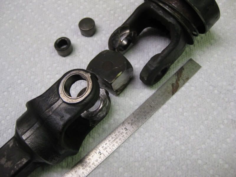

    i am going to try to replace a "cross" & 4 needle bearings in my ariens snow blower. its non- greasing universal joint assembly and quite special as far as i can tell. quick connect spline female yoke on one end, 3/4 x 7/8 shaft welded into the other yoke.
    the dealer wants $300 plus for the little rascal but my feelings are if it has been made, it can be replaced. one of the "pins" of the cross is driven thru the body of the cross, the other "pin" is part of the body of the cross. certainly appears to be hardened something. any ideas from you wizzards of machine work ? please ?

          pix of cut apart joint
          the cross is the ugly square hunk. between the ears of the yokes is 1.0625. i looked at the web site of neapco. all theirs seem to be held together with clips or so. this one was held centered with the press fit needle caps. . .
          a round of material might be suitable but i would just as soon find one somewhere. . . . thanks for looking.
            Is it my imagination or do those yoke have sleeve where the cup presses in? Regardless, nothing says you can't sleeve 'em and press in the caps from a new joint.

              If the piece is hardened, it shouldn't be anything too special. I would think anything from a plain medium carbon like 1050 to 4140 would work. I would think the hardness might be best in the 47 to 52Rc range to preserve toughness as well as adding wear resistance.
              Since it looks to be all press fit for the pins and then retained by press fit bearings, it shouldn't be too difficult to remake if to have a mill.
