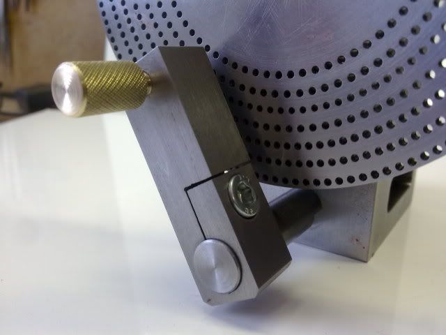

    Been a long time, but finally I have finished a new project.
    It is a dividing apparatus, that is the first step in my project of building a clock
    Any commend is as allways welcome

    Looks good, did you drill the holes by hand or CNC?
      CNC - That's cheating isn't ?
      The plate is drilled by hand in a rather special setup

        Real good looking plate you have there. Nice job, I really like the way you drilled the holes. Can't wait to see step 2
        You can always just EDM it...
          I like how you sawed that split-block clamp - did you do that by hand ? Fine looking piece of work.
            The spilt block was made in the lathe by use of my milling attachment
            The spilt arm was made with a junior hack saw

              I like the compound set up you have used there. Fine looking unit overall.
              I bury my work
                How did you make the longitudinal cut, parallel to the length of the arm? ...thread a hacksaw blade through the hole to start the cut?
                  By hack saw? Is it possible at all?
                  I got it! You read the recently published tip on how to use hacksaws (gold nuggets like "saw blade should be sharp" and "lubrication is helpful").

                      Nice job. Would you describe how you used the gear train to index for drilling the holes?
                      I like the cross slide stop on your lathe too.

                        How did you produce that L slit?
                          To make the L-slit I first thread a hacksaw blade in the hole and cut, next a cut from outside into the privious cut.
                          As for the gear train setup, I kindly ask you to study the photo, I'm sure this tells much more than my words will tell.
                          The tool is not blakened, but the stock piece of steel was painted black in its former life.
                          Thank you for all the kind comments

                            very nice work looks real good!!!!!!! why seven rows of holes?
                              With the 7 rows I can make the following divisions
