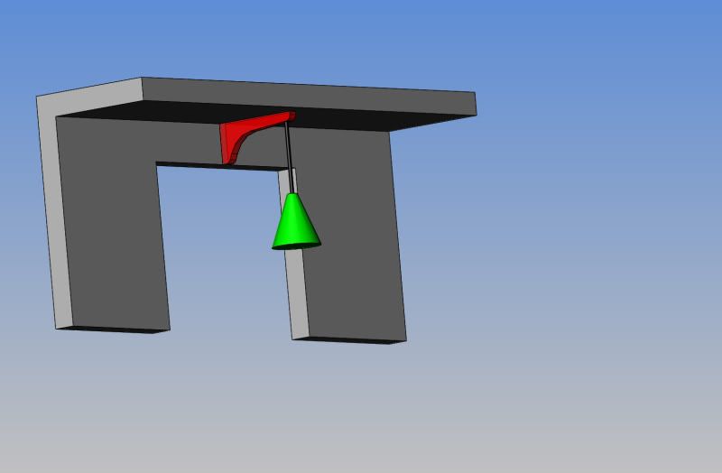

    I know, I know---its a MACHINISTS forum.But please forgive my transgressions. Wife and I are into a kitchen renovation, and she wants the light on the wall above the sink to become a ceiling light. I have no access to the attic in the area above the sink, but have managed to bury the electical cord in the drywall so that it comes out at the very top of the wall. I want to build a cantilever stut that extends about 16" out from the wall, bury the cord inside it, and give her a ceiling mounted light, hanging from the strut. Left to my own devices, I would make it from 2 x 6 pine, but I don't want any grain to show when it is painted the same colour as the ceiling. Is there a better wood to use that will not show grain as badly?---Brian

    Poplar would be a good alternative.
    In fact I'd reach for it before pine anyway. ...tho I guess it depends on the type of pine you have in your neck of the woods.
    ,,,ahhmm, speaking of "neck of the woods", I'm not sure of the range of poplar in the north. Not sure if you'd find it there in Canada or not. I'm sure there are other fairly soft, grain benign hardwood (i.e. deciduous) species native there. ...maybe aspen???

        to be sure of teh no grain MDF or ply would probably be a better bet... ir cover the timber frame in mdf?
          I'd make it out of 4130
          In all seriousness, you could probably do it out of sheet metal and hit it with a good primer that will topcoat with latex paint (assuming that's what you are using in your kitchen). I suppose that's an awful lot of effort to go through, though.
          You could make it out of pine and then hit it with a high-solid primer like the stuff that you put on bare sheetrock before painting. Then lightly sand the primer after it is dry and it will hide the grain. I did that in my parents basement to in a couple of places and it turned out well.
            Brian, just make it out of whatever's to hand, sand it as smooth as you can get it (remembering to round off all the edges so the paint will stick), seal the grain with sanding sealer, sand lightly again, and use a high-build primer on it, sanding lightly between coats. When it's perfectly smooth, undercoat and topcoat as usual.

                    I've got a contractor/carpenter/painter working here and he votes for poplar as well. I will probably go with the poplar, as I don't need much of it. I would be a bit shy of MDF because its right over top of the kitchen sink and dishwasher, and I've had problems in the past with MDF around moisture. Probably my information/experience is out of date---I'm sure they have better resins now than they did the last time I used MDF, which was about 15 years ago.

                        Goose--The area in question is right at the outer wall of the house, on a single story building with 18" of blown in rockwool insulation. The house has beautifull plastered ceilings. I weigh 260 pounds and although I MIGHT be able to squeeze thru the trap door into the attic and swim thru the rockwool to the edge of the attic space, its pretty damn doubtfull that me or the plastered ceilings would survive. As for fishing wires, yes, I could possibly do that, but the Ontario hydro code calls for a junction box attached to the ceiling joists to connect any wire to. My ceiling joists are not centered over the sink. I have convinced the wife that my cantilever strut idea will work, and she likes the design.

                            Poplar probably is your best bet, easy to cut, sands very smooth, fairly tight grain. Totally hiding the grain is a function of lots of paint and sanding between coats. It really won't take real long if you use water based paint. It might seem like you're not getting anywhere but then all of a sudden the grain goes away.
