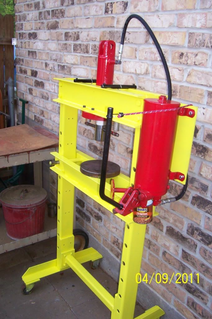

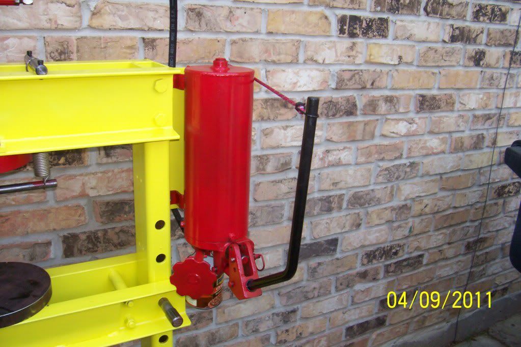

    A few weeks ago i asked about using a hydraulic jack up side down.Well in searching for answers which I got .I came up with a better idea. I found a tilt cylinder off a fork lift at the scrap yard for $10.00 which i used instead . Along with a variable pressure hand pump I had stored away. !500,2.200 are 3000 psi.So here it is .
    Hope you enjoy. I did not have any use for one ,but always wanted to build one. $10.00 for cylinder $12.00 for spray paint and $22.00 for hydraulic hose. The rest i ether had are found for free. Not to bad if I do say so my self . Figured out about 14 ton at 3000psi. yes I had a leak that why the bean can but fixed that Sunday. So the can is gone now. Just a o ring.

            I got a welded 4x4 Chief cylinder to build a post for mine. Using 10" channel for the top beam, it takes more than sixty inches of steel to hang the cylinder above the square press pad on the bottom side.
            I was thinking of disassembling the cylinder and doing a clone of yours there.. Welding the press pad to the top.

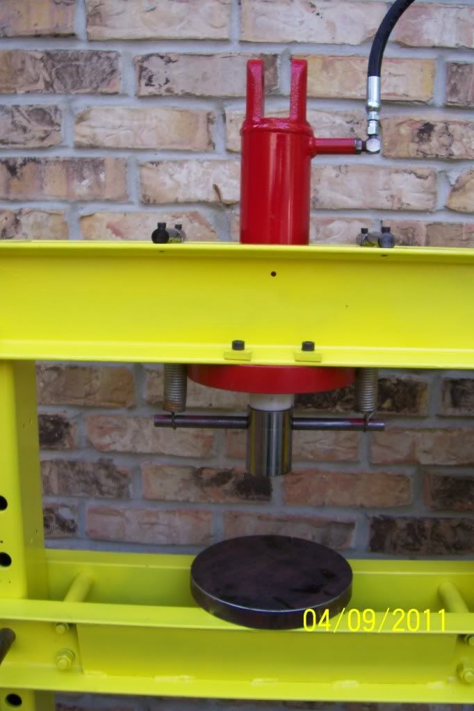

                I do wonder if it would be stronger if the table channel iron rested on top of the pins instead of having the pin go through a hole in the channel.
                At least that is the way my factory built press is designed.

                    It will work both ways .I did that so if needed i could raise the platen up and down 2 inches at a time with out a bunch of holes . They are 4 inches apart. And just received a bigger cylinder I got of e-bay so now I have to rebuild the cylinder mount plate to mount the larger cylinder .
                      I've got two presses. One freebie that I refurbed and a big one that I'm building from scratch. Both are designed so the table rests on pins and has pins go through it. Just takes careful measuring and placement of the through holes.

                              Wheels ?? I looked but diidnt see any locking levers? How do you keep it from Rolling around when leaning up on it while using it? I been refitting my press with a 50 ton cylinder trying to make things fit. Was considering wheels on it (good idea) but only ones i have dont lock? I was thinking of different ways of locking it to one spoot when using it. Any ideas??
