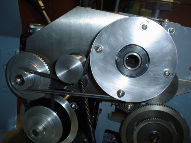

      I used to have a 9x20. I did a lot of work to that lathe. My Friend Rube has it now.
      One of the mods I did was to make a set of pulleys so it could use 2 drive belts in the low range.
      I had fitted a 1hp 3ph motor and VFD and with heavy cuts or parting it would snap the belt often. Adding the second belt eliminated that problem.

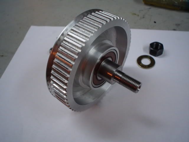

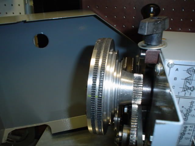

                          This was the dual belt setup I made for my old 9x20.
                          I made the extra pulleys, modified the intermediate pulley for sealed bearings and made a new stronger steel shaft. I also made a wider tensioner pulley for the extra belt.
                          The detent clutch was eliminated.
                          It worked really nice.
                          Steve
                            Now i understand; there are two versions of the 9x20. In canada busybeetools sells the one you've got, and king sells the one i've got. One of the differences is the belt thickness, another is that mine has a sealed gearbox. I would have done the same
