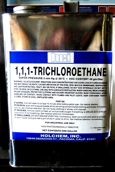

    I still use it mixed 75% trike and 25% ATF to stop it evaporating, as a tapping fluid.
    Can't get any better stuff.
    Just common sense, use sparingly as it's hard to get and don't drink the stuff.

                Trichloroethane works pretty well as a tapping fluid in ferrous metals. It reacts with aluminum , so is not recommneded there. The stuff is superb in vapor degreasers. I wish I had some.

                              I used to buy Trichlorethane by the 5 gallon can when I was foreman in a fab shop. We used it as a cutting fluid in the Hougen drills fabbing structural steel. Since the steel was to be primed after fabrication we used Trichlor because there was nothing to clean off like there was with soluble oils. Whatever you use in a Hougen has to be very "thin" so it can run through the little slot in the cutter pilot.
