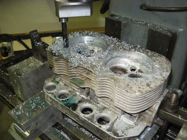

    On my Vertical Mill my boring head mounts to a B&S #9 with 1 1/2-18 threaded end.I am having difficulty coming up with a way to center my work with a test indicator and was thinking about an idea that popped in my head.I could screw off the boring head, screw on a cap that fits the bottom of my 1 1/2-18 threads and on the bottom of the cap a centered stud, hole with 1/4 inch to hold the test indicator with a set screw.One of my freinds wants me to take out my B&S arbor and put my collet arbor in with a 1/4 inch arbor but thats not easy on my old machine.What ya think? I am doing the same task over and over and this set up seems to be faster then swapping out arbors.example below...same jobs over and over.

    Why don't you make an adapter that clamps into one of the boring bar holes to mount the dial indicator on? Taking the head off and on isn't a good idea to me.

      I thought about that at first useing the center hole but wondered about getting the head centerd everytime as well.I guess i could indicate off the fixed part of the head the move the indicator to the movable part to get the head centerd then do the center hole with the test indicator.

          It doesn't matter if the head is centered. The indicator is just like a boring bar. It's a single point tool. If you get the same reading all the way around, then you're centered. It's a comparative measurement rather than an absolute measurement. I agree with Carld.

            OK i guess i am overthinking it.I was thinking i need to be on the quill center axis to get the correct readings all the way around.My boring head has an adapter that will fit in the 1/2 inch center hole with a 3/8th center.If i could find a 3/8 with dovetail end i could do that i guess.I have a 1/4 inch and no way to connect that.

                Your mill is a lot bigger and more rigid than mine but a using the shortest available tool that will get to the bottom of the bore is a good habit to get into. It helps a lot in eliminating the dreaded chatter syndrome. Unless I'm missing something in the picture, that one's quite a bit longer than necessary.

                  Having done many, many setups like you are doing, I always just put my indicator in the spindle in a collet or on an arm that is in the collet and indicate the part. Then swap the boring head for the indicator.
                  It also helps if you have a mill with a digital readout so you can move the part out of the way to give you clearance to swap things around and still come back to the same location.

                      I would love to find a shorter bar with more 3/4 then just whats in the boring head.being a newbie and so many boring bars to pick from at MCS and Enco its crazy.If you have any suggestions and maybe a link to a better boring bar and inserts that cut 90 degree bottom i'd really appreciate it.This little bar cut the bores in a magnesium engine case like butter but it was chattering at the bottom cut on the aluminum head at about 250 RPM and with lots of A9 fluid.I might could try to slow it down some more after i get my set up leveled out.Thanks
