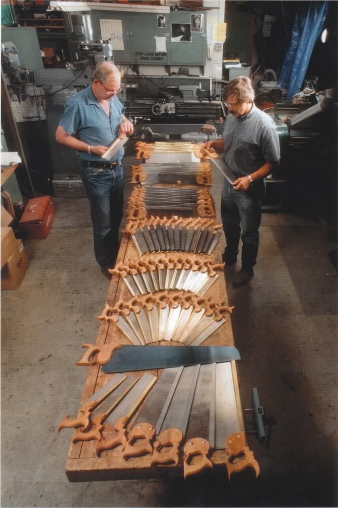

    This bench is about 16' long. It is full of various 18th.C. style back saws Jon and I made as Toolmakers in Williamsburg. Jon is on your right. I am on the left.
    There is 1 crosscut saw shown. We made another bench full of crosscut and rip saws. I did not start photographing ordinary tools before this. We just had special presentation pieces photographed before this,as I did not consider tools of this type as special. They were our regular production.
    Sometimes we had to make displays of our work,and used photographs as part of the display,since the original work was gone to their recipients by then.
    Some guys began to say that we only made gifts,when they knew perfectly well that we made every day tools since they were using them in their shops. Typical.
    These are made with blades of 1095 spring steel. Their backs are 260 alloy brass,except for some earlier 18th.C. patterns that used iron backs,which you can see here and there.
    The handles are all beechwood. The saw screws in the handles were cast in the Geddy Foundry from patterns I made. Then,we threaded and finished them. The earliest pattern saw we reproduced used iron screws and square nuts,as special saw screws had not yet been invented in the 1760's.
    We made a special brake for partially bending the saw backs,and a press for squeezing them down until their gaps were thinner than the thickness of the blades they were to grasp. Then,we tapped the blades into the backs with wooden mallets.
    Fortunately,I was able to find an old 1940's saw toother to punch the teeth. They were sharpened and set by hand after being punched.
    Nearest you,there are 4 larger tenon saws on the bench. The 2 with iron carriage looking bolts with rounded heads are the earliest style of "White" brand saws. Only 1 is known to have survived. It is a brand known to be popular in Va. in the earlier 18th.C. Note how the saw backs stick up out of the handles of these White saws. They hadn't thought to gracefully terminate the backs inside the handles until later decades.
    The other tenon saw with iron back is a "Cartwright" brand saw. They are from the 1770's,and do have special brass saw screws by then.
    The saw on the right hand side of the leading edge of the bench is a Kenyon.
    If you study the handles of this first row of saws,you will see the stages of development in handle styles. The earlier handles look undeleloped compared to the Kenyons that are from the 1780's.
    The smaller back saws seen to the left in that first rows are also Kenyons,with open handles,as was the norm for smaller size saws at that time.
    We were able to bandsaw the shapes of the handles out,but most of the rounding over of the handles had to be done by hand.
    The blue color seen on the 1 crosscut saw is the color of the spring tempering of the 1095 spring steel we used.

          About $300.00 for a back saw. But,the only way to get tools that were really correct for the period,was to make them. Before I started the Toolmaker's Shop,craftsmen were using incorrect,sometimes modern made wooden planes,incorrect saws,etc. They were sometimes using antiques,which was against museum policy,even if the tools were their own property. Even then,their antiques were usually late 19th.C..

              Re: the saws: i didn,t notice any that had that little "nib"? sticking up on the end of the saw ,, that must be a later thing?
              I,ve read a few explainations about that nib, everything from just a decoration,, to it held the string on the end that kept the wooden blade guard on it.
              Think it was Eric Sloan's book that suggested the latter which made sense.
                That is my wife in the photos.
                The nib is seen(if you can see it) on the crosscut saw. I agree,the nib kept the string that held the tooth guard from sliding off.
                Itinerant woodworkers often carried their tools loose in baskets back then,and the saw teeth would mess up the other tools,or be dulled by them. They took a long strip of wood and slotted it lengthways to tie over the teeth.

                    The ordinary tools made in the 18th.C.,like saws,were left with rasp and scraper marks on their handles,and sold with teeth that were not sharpened. Chisels were sold un handled. You were expected to file your saws and put handles on your chisels yourself.

                      Re: the "Beech" handles,,, was this the most common wood used for handles?
                      I had a very old 12 point saw back a few years ago that had a formed brass guard on the underside of the handle, (and yes it had that little "Nib",)
                      That date on the brass guard was i think 1905, sold the thing on ebay to a saw collector i think from Connecticut?
                      Anyway this saw appeared to have a handle made from "Applewood."
                        Beechwood was the wood used on the vast majority. It was cheap and plentiful. Applewood was used on the high grade saws in the 19th. and 20th.C.'s.
