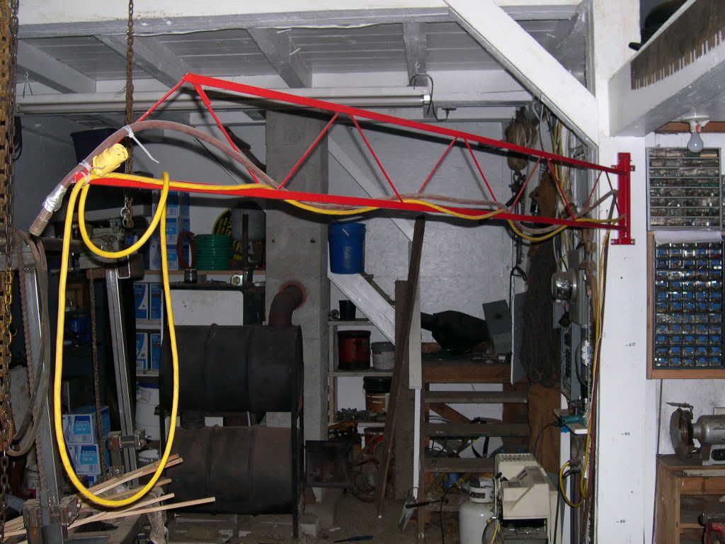

    I don't know quite where to put this. There was a thread on hose reels which this isn't and this isn't quite nice enough for 'shop tools'.
    I got tired of stepping, tripping, and rolling on cords and air hoses.
    This fits between the bottom of my lights and above my head - two critical design parameters. Super easy to build. Swings out for working on equipment and under for working on a bench and welding table.
    The clutter in my shop will make everyone feel better about the cleanliness of their own...

      Nice solution to keeping cords & hoses off the floor. I saw a fellows shop where he made something similar, but it was two sections that were hinged in the middle, mounted to the wall at about 4' high. Each section was about 12' long and he mounted his mig welder on the end of it. when it wasn't in use it swung over against the wall and when he wanted to use it he could swing it over all of the engines, work benches, and other stuff he had sitting on the floor to reach the area he wanted to use it.
      Of course it truly was a dream shop. Had a room for his machine tools,
      next to the room for his woodworking tools, an office, compressor/sand blast room, you get the idea...
