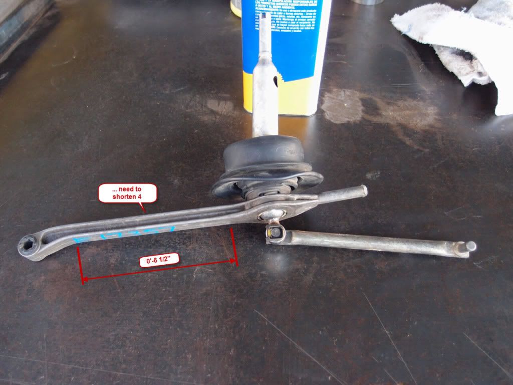

    I was asked if I would shorten this. It's a shift linage assembly for a BMW. It is probably pot metal, it is not magnetic. Looking for some suggestions on modifying it, if you have any.

    Knowing BMW, that's probably cast aluminum. Taking 4" out of it should be no problem. Fastening it back together afterward, not so much.
    I think you could get it quite strong if you could make up little tie bars to lie in the U-channel, then screw through the wall into your new tie bars. Does the part have that channel on both sides?
    The easiest thing, if it is aluminum, might be to find a good TIG welder.
      I am a TIG welder, just never welded aluminum and I don't have a HF machine anyway. It might be cast Magnesium too, dunno. Yes, there is a channel on both sides (it's like a small I beam). I wonder if something like Dura Fix would work, use some of the scrap that I cut out and make flats to weld in the channels with Dura Fix.
        BMW is also very fond of Magnesium,so you might want to do some simple tests before whipping out the TIG torch.Scrape a small pile of shavings off with a knife and see if they light with a match.
          It doesn't look like it would be that hard to make one of those from scratch. Even as a weldment--Keep the original as is. A single bar with a forged flat for the ball and you're halfway there. The pivot can be turned down. Think about duplicating the function, not the form.
          I doubt that's pot metal. Either aluminum or mag alloy. Ditto doing a mag test though if you plan to weld. Magnesium doesn't stop burning until it's gone.
            yes when you take a look at what your all removing there really isn't going to be much left so I would seriously consider building one.
            It's hard to say what BMW is using as material - Iv seen them get carried away in area's that don't really matter much and then seen them using boat anchor material on area's that do (un-sprung)

                I'd do what Pixman suggested. 2 rods glued into the channels and pinned.

                  ... for those asking ...
                  The car is a 1969 BMW 2002. It was originally an automatic. The only reason this is important is because the transmission tunnel is larger on the automatics than it was on the manual. The motor and tranny combo that is going in the car is a BMW M20 from a 1991 325i. The transmission is a Getrag 260 that comes with the M20 motor. This motor and tranny combo places the shifter approximately 4" further back in the transmission tunnel than the M10 with Getrag 240 that was stock in the 1969 BMW 2002.
