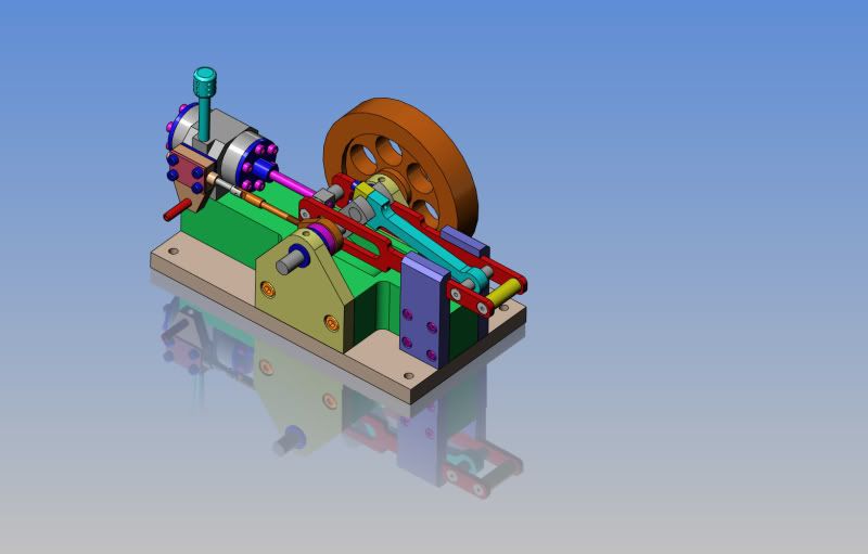

    I was so taken by the twin cylinder Potty Overcrank Wall Engine designed and built by Sbwhart http://www.homemodelenginemachinist....?topic=12367.0 that I may attempt to design and build a single cylinder Overcrank engine. One or two years ago I built my version of Elmers #33 mill engine, and it turned out quite fine. http://www.homemodelenginemachinist....p?topic=7340.0 (That was the engine that powers my Pumpjack.) It was a double acting single cylinder engine, with a slide valve arrangement similar to the valve arrangement on the Overcrank engine built by sbwhart. I will probably plaegerize the design of both the aformentioned engines and add some unique design elements of my own. Although I doubt that my work will ever approach that of Elmer Verbourg or Stew's, my engines do seem to run reasonably well. I will be simplifying the design, and configuring it to work with my favourite #5-40 fasteners. The Elmers#33 engine had a 1/2" bore and 1" stroke, while the Overcrank engine by sbwhart had a 20mm dia bore and a 36mm stroke. (Roughly 3/4" dia. and 1 1/2" stroke). I don't like to work on very small parts, however I don't want to design an engine so large that the modellers with smaller capacity lathes and mills are unable to build from my plans. The design will be done in Imperial units----(I can work in metric, but I'm much more comfortable with inches.) I will design in Solidworks 3D software, but the published drawings will be saved and posted here in a .pdf format. Welcome aboard, hope you enjoy the ride.----Brian

      Well, there we go---that wasn't so bad!! Basically, I took the 1/2" bore x 1" stroke cylinder from my version of Elmers 33 mill engine, and redesigned it for a 5/8" bore x 1 1/4" stroke. I am going to use the exact same steam chest and valve, so I kept the cylinder the same in the critical area where the steam chest fits up to it. Of course the raw stock for the cylinder jumped up from 1.031" square to 1 1/4" square to accomodate the larger bore. The #33 engine cylinder was 1.375" long with a 1/4" thick piston and a 1" stroke, so I pro-rated sizes to accomodate a 1 1/4" stroke with a 1/4" thick piston, which changed the overall cylinder length to 1 5/8". This is my starting point only. As this design progresses I may have to change/re-arrange things, but now I have a "baseline" to work outward from.
        Thanks Stew.---After a quick check of available stock, a corporate decision has been reached to use 5/16" diameter stock for the crankshaft with 1/4" x 1/2" bar stock for the crankshaft "webs" or "throws" depending n what you call them. the crank will be built up, pinned, and loctited.

            Job is on temporary hold again. Thats okay---I have sussed out the overcrank guides and the connecting rod. It all works well and everything clears okay. if you click on the top picture you will see an animated video of it working. I just spent 20 minutes talking to my Solidworks provider figuring out how to make an animated video that lasted longer than 10 seconds.
              GENTLEMEN----We are ready to ROCK!!!! I squeezed out an hour at the end of my day to complete the model and I think it looks great!!! Tomorrow I will root through my pile of aluminum bits and see if I have a peice to start the cylinder. I will create detail drawings and post them as I progress, but my advice is that you don't copy them right yet, because this is a "prototype" and the drawings may change as I get deeper into it. I will post a download for all of the updated drawings at the end of this game, when I have this engine running.----Brian
