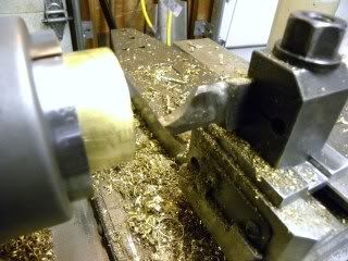

    I am having trouble creating this feature in the end of a 2" brass tube.
    The large entry groove is about 1/4" wide x 1" deep with a square shoulder at the bottom (it can have a small radius). In the middle of that groove is a narrow groove about .180" wide x 1/2" deep with a full radius at its bottom.
    Altering the design is not an option.
    I had some success with this trepanning tool (I had to modify the radius and weakened it) until the insert caught and broke the tool. There is an unmodified one next to the broken one.
    I then, with with this style of trepanning tool, had some limited success, but the ID and OD dimensions weren't true enough.
    I plunged the intial slot about .210" wide and then attempted to open up the slot. The slot has some taper in it, and I thought the tool must be rubbing and deflecting, so I attempted to grind the side radius a little to give greater clearance. So far, I am unable to determine if the OD is narrowing down, the ID wall is expanding, or both. I have a gage ring that binds as I try to insert it.
    I'm very frustrated with the large groove and haven't even begun to tackle the smaller groove at the bottom.
    I'd like any and all suggestions on how to machine this feature(s). I am willing to take the parts to another shop, if I knew what process would be best. I am only showing this one aspect of the part, as it is proprietary.

    Use a tube shaped tool
    For the depth and width of the features, you probably want to make a tool similar to one on the market called a rota-broach. It looks like a very stout hole saw with a triple chip cutter pattern and relief areas that allow the chips to exit. You will need a series of four, a roughing tool for the large groove, a finishing tool for the large groove, a roughing tool for the narrow groove and a finishing tool for the narrow groove.
    A parting type tool with a curved body will likely deflect and roll up in that deep a groove.

          I did buy carbide-tipped holesaws made by Morse in 1-1/2", 1-5/8", 1-11/16", and 1-3/4". For some reason the holesaws required way too much pressure on the downfeed of my Bridgeport. I would have thought they would have cut thru that brass like butter, but it was not so. The brass was supplied to me, so I can't be sure of the alloy. The drawing calls out "brass" with no specific alloy being specified.
          I have several annular cutters (forget the manufacturer - could be rotabroach) and they were my first thought. Their "wall thickness" is too great. Thinning the annular cutter didn't look like an option due to the "tooth design" which places angled facets both at the ID and OD of the tools.

            A special ground trepanning tool seems the only way to me, but something less than .180" wide sticking out over 1.5" with a full radius on the end is going to be a challenge.

                      The parts are less than 6" overall length. I know a couple of good CNC shops with vertical machining centers (one is the shop where I bought my Hurco's). I'll take the parts to them tomorrow and see what the owner's say. I think they'll balk at the depth and diameter required for the smaller slot. With their high flow coolant systems, they maybe able to flush the chips out sufficiently to allow the use of a 1/4" shank with 1/8" cutting dimension. A reground 3/16" ball end mill (reduced to .180) could be used as a final tool to generate the radius at the bottom.
                        Generating the form is not the issue, there is more than one way to do that. Tool rigidity is the problem.
                        I suggested a trepanning style tool as that would be the most robust (ie rigid) tool that I could think of. Any type of rotating or conturing tool would have to be even smaller for clearance purposes, not to mention chip evacuation. Or am I missing something?

                              Chances are you will have to make your own custom tool, so what I'd suggest is turning some steel to a tube shape, with ID and OD to match what you're doing, then add some cutting edges onto it. I would use three cutters, equally spaced.
                              One way to do it would be to turn the tube to sizes, then drill three dimples equally spaced in the end. Silver solder three ball bearings into those, then grind on each to leave a half-round cutting edge behind. If you grind just over half the thickness of the ball away, you'll have a round form with some relief angle behind it.
                              Seems the initial slot is about 1/4 inch wide- seems you're good to machine that, otherwise make a tool with 1/4 inch ball bearings to do that part. The next one is 3/16 wide so use 3/16 balls for that one. The tools are self-centering by virtue of having three cutters, and it wouldn't be difficult to hold them in the tailstock. All you need besides some pressure behind it, is to keep it from turning.
                              It might make more sense to mount this tool on the mill table, centered under the spindle. Mount the workpiece in the spindle and lower it onto the tool. You will have to keep raising and lowering the spindle to allow the chips to fall out, but at least they will fall out. That might be a large part of the battle- avoiding jamming because of the chips.
