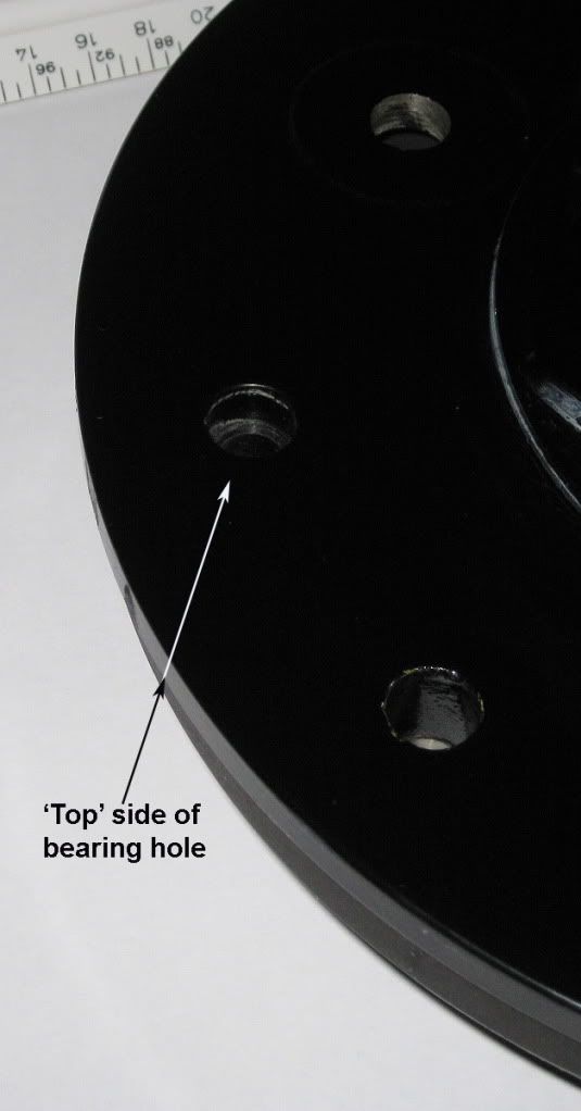

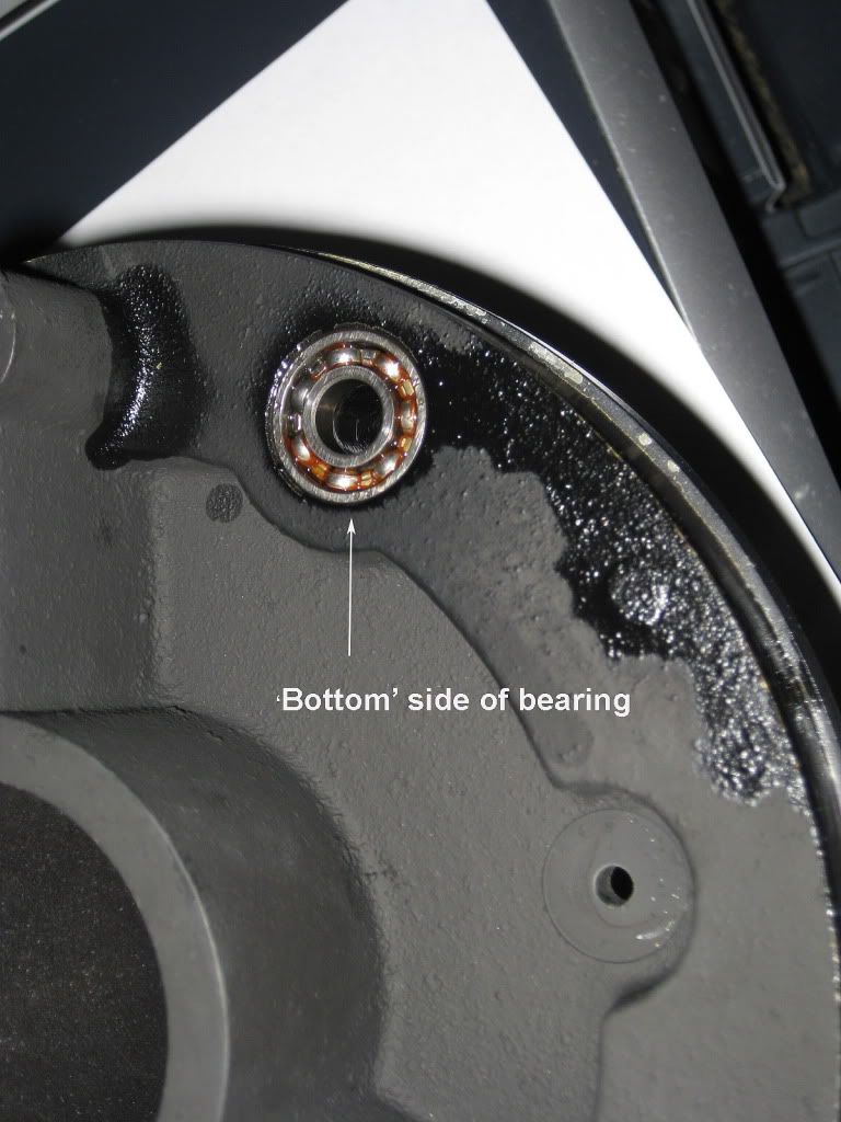

    Looking for a suggestion for two about removing a bearing on the rear plate of this old solar telescope a friend of mine owns. You can see in the photos that there is no way to pull the bearing, because the hole in the rear plate is identical in size to the I.D. of the bearing, so there's not enough of the face of the bearing to punch out or grab. How do you remove a seated bearing like this?

    See if you can rent or buy a blind bearing tool.
    http://www.tooltopia.com/otc-tools-4581.aspx
      I'd stick a bolt or something in the ID and tack weld it to the inner race, then press/tap it out from the other side.
        Either make or buy a cheap expanding arbor. Insert arbor from "top", tighten expanding bolt on bearing, hammer from "top" on arbor. http://www.mcmaster.com/#expanding-mandrels/=e4gt9i Like that. Harbor Fr..... is fine. No need to spend more than $20. There are specialized "sets" like dp mentions that are made for specific bearings if you are doing this all the time. For onesy twosey don't spend the money, IME. The expanding mandrels work fine.
          I think I might try sizing a rod to a close tolerance fit and locktite it or superglue it to the inner race of the bearing. Might give you just enough grip to remove it. And it won't damage the hole if it doesn't work.
          You might also try drilling and tapping the end of a slightly oversize rod and then cut two slots in the end resembling a "+" sign so the rod expands when a set-screw is driven into the tapped hole. Then you will have something to pull on or drive against.
          You might also consider drilling the rear hole a bit larger and then press a sleeve into the hole once the bearing is removed.

            Are u replacing it?
            if so then dis-assemble the cage and extract the inner race and balls - then maybe you have enough angle to get a drift punch in there and work the outer race on out...

                    I just use a slide hammer with a blind bearing puller. I have on occasion drilled two or three small holes from the rear so they intersect with the outer rim, then pushed or punched them out. A dab of JB weld seals the holes after if required.
                    Another way is to grind (die grinder) a couple of pockets in the bearing inner race, then expand a split post puller into it. In your case, you can likely get it out by slitting a bolt for an inch with hacksaw, insert into the bearing and drive in a wedge from the back. The expanding threads will grab.

                            Put a rod in from the side with the outer race that just fits in the inner race and level with the inner race. Turn it over and stake the edges of the rod with a punch. Then heat the casting and use a punch to drive out the bearing.
                              Like Boomer said remove the cage and balls. Then use your welder (MIG, TIG or stick) to run a bead about 1/4 the ID of the race. The race will fall right out. Works like a charm and won't heat or damage the casting at all - as long as you can weld in a straight line!
