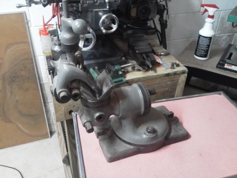

    Hi all,
    My first post here. I registered the other day but haven't had a chance to do anything until tonight, and coincidentally now I could use some help. My dad went to an equipment auction today (I was unable to attend which is good because we would have more equipment than can fit in the shop now) and got a couple deals. One of them was this contraption, which I can't figure out. It appears to be an overly complicated vice for holding round items for milling operations. Does anyone know what it is, who made it, and what might be missing from it?

      I've never seen one of those before, but I'd say you're on the right track. It may be more suited for a tool & cutter grinder or surface grinder than a mill though. If milling, I would only take light cuts.
        Hello,
        I believe it is a tool and cutter grinding fixture.
        Toolznthings
          That is a holding fixture of a Covel tool and cutter grinder.

              Nice unit, it would be worth a few dollars.
              Their are smaller Chinese ones around that are similar and even they sell for a bit.
              Might be worth while putting it on ebay and let the customer work out the price.
              Dave
                That looks like it could be used for machining compound angles for pipe ends such as bicycle frame parts. I'd hate to think what you'd pay for that if you needed it and didn't have one. McGyver did a very nice scratch build project documented here:
                http://bbs.homeshopmachinist.net/showthread.php?t=14890
                  That looks far too handy to exchange for mere money, or other bits n pieces - the day will come when that is exactly what you need to do a job.
                  Tel
                    It almost looks like an attachment to sharpen drills.
