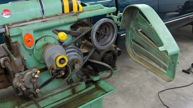

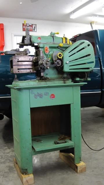

    I've wanted a small shaper for a long while now and recently found one that wasn't too far from home. It's an Atlas 7B shaper and seems to be complete. It is on the factory stand and has all of the belt covers, the factory vise, the wrench that fits the vise and all of the adjustments, and everything is in working order. It was apparantly stored near some woodworking machinery as it has a little sawdust on it but I believe it will clean up very good.

      You got the original stand,too. Those are nice looking little machines.
        Nice looking shaper,real nice to have all the covers.
          Very nice machine. looks like the knee feed mechanism had been replaced with new parts, so all should be good there. I have had had one of these for years and it's a fun and very usefull machine to have in a home shop where odd "one offs" are the common rule. It may not be " high production" but with zero cost tooling it's very versitile. Be sure that the installed on-off switch is in place and works, this is used in conjunction with downward pressure on the belt tensioning lever to act as a ram jog brake. This neat feature may not be readily apparent to a new user.

                Covers, heck.......... They are almost a nuisance....... but HE got the VISE with it........

                    It does have the brake built in to the clutch lever. I do need to get some new belts and make an adjustment to them as it wants to crawl when the motor is on even with the clutch lever in the down position.
                    He gave me 2 manuals with the shaper also so I'm all set. I also found a copy of the southbend shaper manual that I'm using for reference also.

                      Do you mean YOURS is for the mill?
                      Because the one in the OPs pics is definitely the shaper vise........ The mill vise has 2 screw hold-down to the table.

                        I too have been watching for the same unit.
                        Man that thing looks complete and in very good shape, even the paint.
                          No,yours has a 4 bolt base for shaper. Mine has a 2 bolt base for a mill. Otherwise the same vise.
                          My first mill was an Atlas. Saved the vise. I had an Atlas shaper we got on trade at work,but I traded it off. I wish I had kept it as it is a very beautiful little machine,and probably a lot more effective than the Atlas lathe or mill,but I have a larger shaper. I'd sell my shaper,as I have 3 milling machines plus slotting heads,and never use it.

                            I'm considering painting it back to the original gray color, I'm not too fond of green. But I think it should clean up good even if left green.
