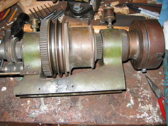

    headstock (detached)

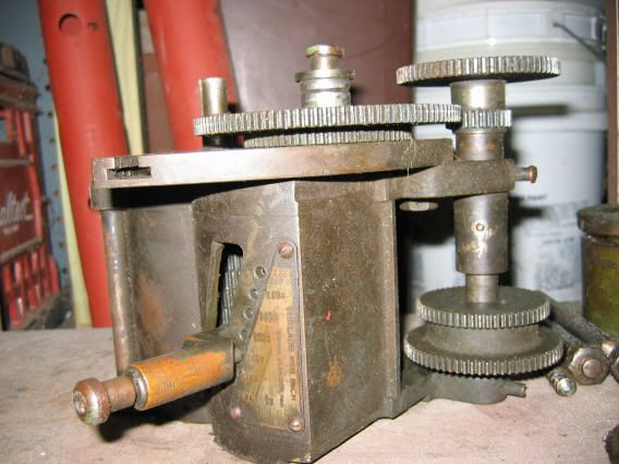

    quickchange (detached before I bought it.... found inside cabinet, apparently prior owner had no clue)

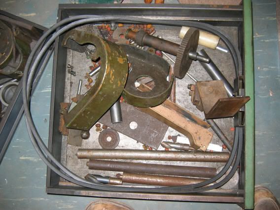

    one drawer of stuff

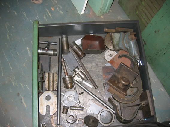

    other drawer of stuff

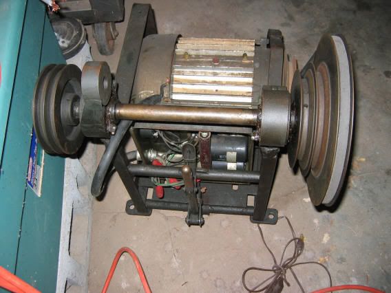

      Under-drive unit as-is

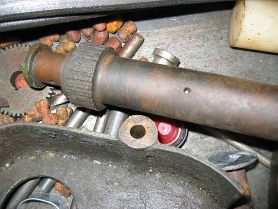

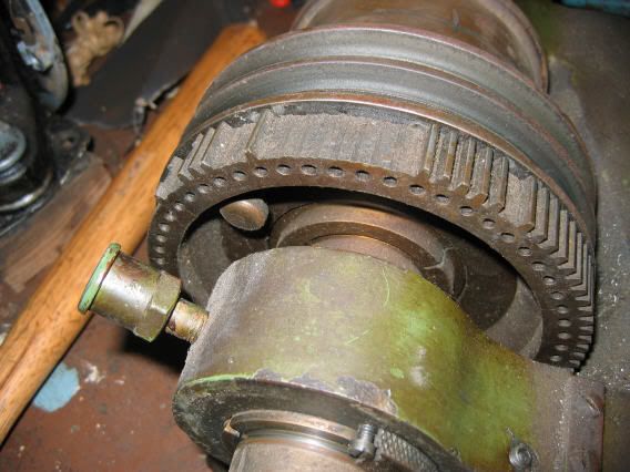

      Ugly No 1.... you probably saw this already
      Ugly No 2..... no better than No 1........

        Ugly No 1 and 2 are not good.... I suspect No2 can be welded up and then teeth cut again without horrible distortion, possibly not. Ugly No 1 is a question.... a sleeve maybe, I don't think welding is going to be good, and there are a lot of teeth missing for a braze-up.

              Looks like the bull gear has a crack in the hub.
              Is a Rivett a well-regarded lathe?
                It isn't a crack, it is an intentional cut, purpose unknown to me right now.

                              The busted back gears are very common. I had looked at a 608 locally a couple years back and it had the same issue.
                              From what I understand you can shrink new ones on.
