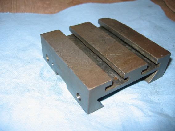

    Well, after finding the right levers (there are plenty) I removed the crosslide assembly, and managed to remove the T-slot topslide from the rest of it.
    The ugly remainder seems to prove that the previous owners, despite seemingly being automotive-oriented (drag racers and chassis builders), were apparently not familiar with a substance known as "lubricating oil". The gunk left in there, and on top of other areas, is quite sticky.... after removing the topslide, my hands looked as if I had been doing vehicle suspension work.
    I hope they clean their rebuild engines better than they cleaned this.... What you see in the picture is the topslide way. (The acme nut reaches under the flat top on an arm, similar to many watchmaker lathes, so you don't see a slot for it).

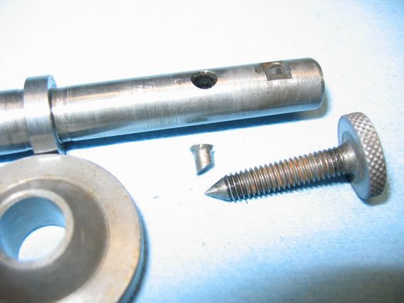

          On the Rivett 608, for crosslide and topslide, each feedscrew has, in the end of it, a thumbscrew. These are called "dial binder screw" in the parts list.
          Well, I wondered about them, but now my questions have been answered.
          The handles are secured by a setscrew hidden in the ball-end handle, passing through the larger ball. So the handle is fixed, without the usual nut on the end of the feedscrew, and the dial is free to turn next to the handle.
          What the Rivett folks did was to drill a hole halfway through the screw shaft, crosswise in the screw, and another hole lengthwise, which is threaded. They inserted a tiny "foot" in the cross-hole hole. The "foot" has an angled surface on the inside, and a raised area on the outside.
          The "binder screw" has a cone point on it. When you screw the thumbscrew in, the cone point forces the tiny "foot" out and "binds" the dial in whatever position you want.
          A very clever and effective device, worthy of a German or Swiss machine.

                      J Tiers, thanks for showing the "trick" for locking the dial to screw shaft.
                      Don't have a Rivett lathe but do have the Rivett cross-slide assembly just like yours and couldn't figure out how the dial stayed where set, was guessing was missing somekind of friction washers. After your showing the locking foot went out and looked at mine and they were both missing. Simple job to make new and works good now.
                      Like the neat way they lock the compound from swiveling, sure beats using a wrench in the slots.

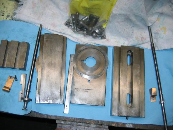

                        Last night got the rest of the slide parts cleaned up.
                        So far, they all will need scraped-in. There is no point in having it apart and NOT doing that.

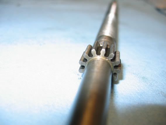

                        It appears that I will also need to make one "dial binder foot", a couple of feedscrew nuts, and crosslide feedscrew, which of course is the one which has a pinion cut integrally into it, making it harder to do.
                        The crosslide screw is Acme at the ends, but Whitworth in the middle. I doubt that Rivett had that hard a time making up their mind what to cut.......
                        The amount of swarf that was removed was shocking.... I could probably have half-filled a "35mm film can" if anyone still recalls those.
                        And the oddest thing was noted.... the feedscrews pull out through the bearings in which they run. But these refused to come out easily... and the worst of them was the crosslide, where the WORN part was the portion that stuck the hardest.
                        I don't know if wear can "upset" the diameter. I'd have said it was unlikely, but then..... the crosslide was for-sure bound up in the worn area, but slid out decently at the unworn ends. Still true with everything squeaky clean except for a light oiling to preserve them.
                        Pic of parts. Believe it or not, this is CLEANED.... before cleaning they were a dark color between burnt umber and dark Sherman tank green. The purple cleaner in which they were soaked for cleaningwas pretty much exhausted.

                              The pinion root clearance is at the diameter of the shaft. There would be nothing much left for shaft if I had to have a gear hub and then two portions of shaft loctited together.
                              Pic is misleading, there is an undercut that makes it look like teh root is way bigger than the shaft. it ain't.
