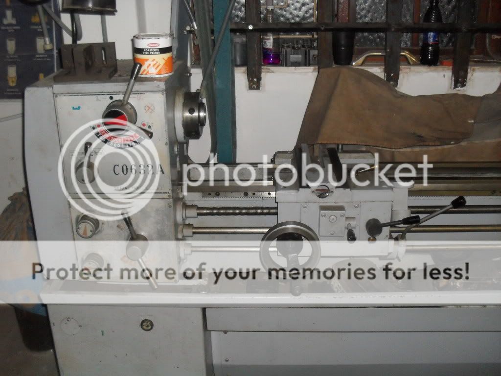

    My first lathe I bought was a 13x40 Chinese lathe . I got caught real bad and have spent more money trying to fix it than what a new one would have cost. Any way it has been reground and has turcite under the saddle . Feels real smooth .I have to learn to scrape the toolpost and crosslide in. I hope this is not beyond me. There are no scraping schools in s africa. Anyway I hope someone could help me out .The aluminum gear chart is so worn I cant make it out. I got some gears with it but am not sure if they are the right ones as the lathe had parts mixed up with a lathe next to it. I see a couple of photos of this type of lathe and wonder if they all have the same gearing I am hoping someone could help me out with a photo or copy of a manual if it is not to much trouble. How would I be able to get a new gear chart made up? Do you think there are printing companies that could do this on aluminum.I would love to get this lathe running as I hate incomplete projects Thanks.

      I have the 120/127 gear. The workshop is all closed now so tomorrow I will check to see what smaller gears I have I soppose its a good start at least.I am seriously mathamatically challanged . Sounds scary hard to work out. Does this lathe look similer to yours. Mine is quite old so it might even be taiwanese although when the headstock came off the bed under the headstock had been ground in with a angle grinder.Those chinese are highly skilled They can do with an angle grinder what other fitters do with a scraper
        Yes, it does look like mine although they have tried to make it look quite different. For instance where you have two levers mine has two knobs but it is a fair bet that inside the box would look much the same.
        Obviously the two levers at the top set the spindle speeds, mine has two knobs to do that. On the lower gear box you have two levers and 2 knobs, mine has four knobs.

                I hope to finish this lathe project off. I cannot believe how fast time goes. Anyway I got this lathe up and running except for the compound.I will need to learn to scrape. But my first problem is the gearing. I hope someone has the exact same lathe.I am using a block instead of the compound but I find the feeds on this lathe too fast.I will try to get my head around the feeds before I understand the threading feeds. I am also waiting for the artfull bodger to finish his post.
                I cannot read the feed chart so i tried to do what The Artfull Bodger described but I am needing time to take it all in.
                This is the question I would like to ask. The slowest feed I can achieve is if I put my smallest gear on near the spindle.Then I am using an 85 immediate or idler gear. I have a 100 gear on the bottom and this seems to give me the slowest feed.Would this make sence and does the idler have no bearing on the speed of the feed.I am trying to understand the two levers on the bottom right of the gearbox. This seems to control the feed but has little bearing on things. I notice that if I put the top lever through its range all the letters which I think are marked J K L and I think m will controll the feed and lead screw except for L which only controls the feed and not the lead screw as well.
                Also is there a easy way to know if my lead screw is metric or imperial. Being S Africa I would have thought it is metric and if I use a pitch guage it seems to be three millimeters.The gears that I have are 127/120 85 idler and 100,60,52,46,45,44,40,33,and 30

                    Yes, the slowest feed is with the smallest gear doing the driving and the biggest gear being driven, you are correct in that the idler has no bearing on the ratio. It is obvious that your gearbox had quite different internals to mine and that gearing you show would be very slow on my lathe.
                    The easiest way to check your lead screw is to measure off a distance along the lead screw and count the threads, it will probably be either 3mm or 8TPI.
                    One of those levers probably switches between lead screw and feed drive. Move the lever to one position and see which rod can be turned by hand.
