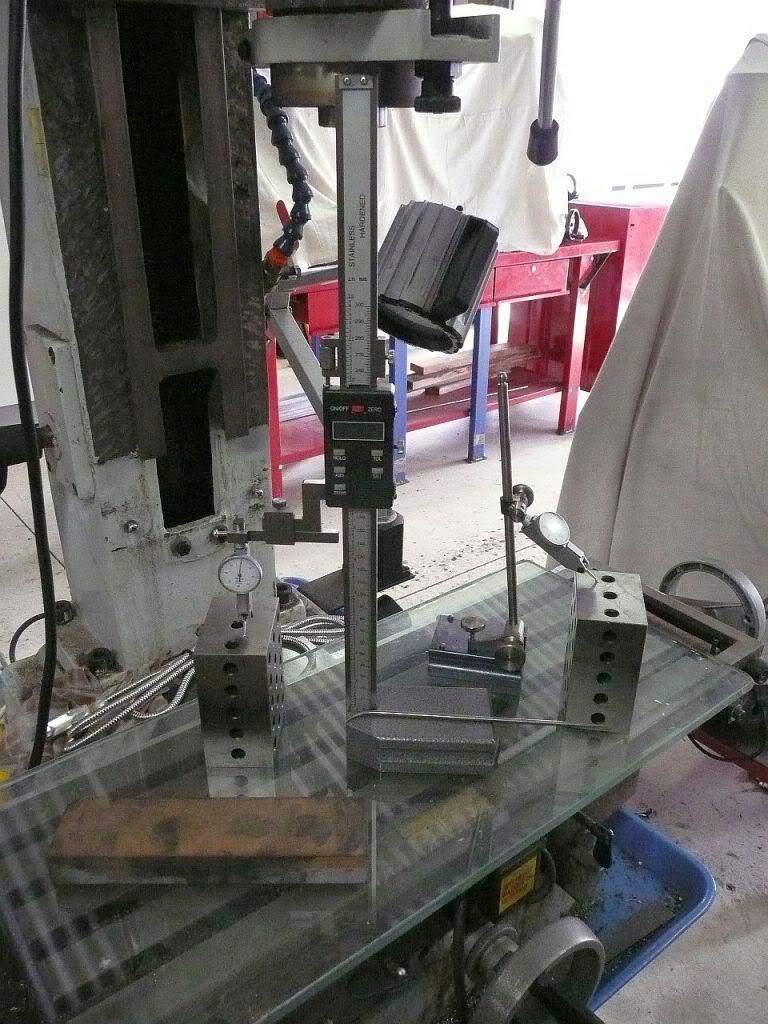

                        Also I owe thanks to someone at this site who suggested using a glass plate as an alignment tool.
                        Pat
                        Pat.
                        I think that may have been me (75 in 6 weeks).
                        Use say 1/2"+ polished "float" glass as a surface plate or marking-out/setting-up table and if well supported (I use "Painters" masking tape strips at 4>6" spacing) on my mill table it is great. It is almost indestructable and near enough to dead flat (about 0.0001"/") and is hard to scratch etc. It is required for "safety glass" for large glass panels in public places. I've dropped mine on its flats, ends and corners and no damage. In the unlikely event that if does break it reduces to small non-sharp bits - and certainly not to razor-sharp shards as some seemed concerned that it might. I just stand it at the end of my bench where its out of the way between uses.
                        I like being able to take the plate to the job as its certainly lighter than a surface plate and a lot safer to lift and not a PITA at all.
                        If I need another for what-ever reason I get it from the local Glazier who will run the arrises (sharp edges) off and rounds it on his grinder. Costs very little.
                        Its only rarely that my surface plates (very good black granite) get to see the light of day (or the shop). I don't know what they get up to in the dark - and I don't ask!!!.
                        I very much prefer the stock-standard surface guage to a 12" digital (even vernier) height gauge as I can make masts and "pointers" to suit my SG and it can get into some very tight corners that my VHG cannot. The height guage all too often gets in its own way and mine!!
