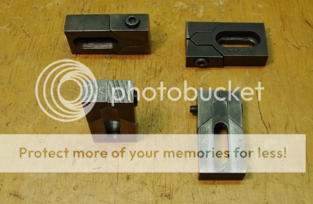

    After seeing Sir John's post about this type of clamps I thought they would be a good addition.
    I saw some on Ebay and ended up wining the auction!

    Ok i'll bite, how do they work. Do the jaw looking pieces slide forward on the angles to push up against work on the table?

            Note the upper left clamp. It seems to be designed to force the work against the table.
              John posted a picture of how these clamps work. I don't know the thread the pictures are in, sorry. I know they push against and down on the workpiece.
                I'm guessing they are all the same, looks like the main body is clamped to the table and as the cap head is tightened up it forces the 2 loose jaws down the angle and advances them to clamp the work side on??

                  BF, or anyone else, AMF is ?...can someone narrow it down a bit...I find anything from a file type to a bowling ball...the clamp work method is as has been posted...one advantage, from someone posting to the above thread, appears to be being able to tighten to the workpiece even if there is an overhang in the way

                        Looks like you bolt them flat to the mill table using the slots. With the socket head bolt loose, you push them against the edge of a workpiece and tighten them down. Then when you tighten the socket head bolt, the loose pieces force against the edge of the workpiece to hold it. That's my guess, anyway.
