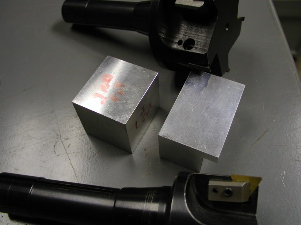

    I have to say it's your cutter. I milled these blocks with my 2" shell mill. Three Kennametal TPG 322 KC 730 grade inserts in the mill. I don't remember the RPM's or feed rate, no coolant either. I get a mirror finish with just about any RPM as long as I don't over feed it. You need dead sharp inserts and not too sharp of a radius on the insert.
    Pictures aren't too good but !

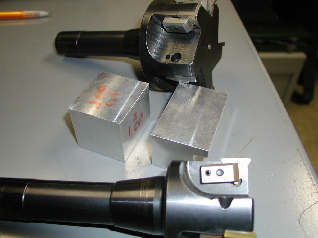

                  Update New Tool
                  New tool better results...
                  Thanks for recommending glacern 45 degree face mill, when my budget analyst(wife) says okay I get to order it!!!
                  FM45-250
                  I did try some of the suggestion from last week , like only using one bit on the shell mill, but it was still the same results
                  Below is my new fly cutter (import) from RL Stevens al7 c2 bit
                  tried various speeds and feeds all with about the same results
                  I am still trying to learn the math correctly IPM and IPR(asked in a different post)...
                  below the fist 2 pics are, left: last week with the shell mill and right: with the new fly cutter 600 rpm 2 IPM.

                    timcki, look closely at the cutters I use in my fly cutters. If you will grind a 30 to 45 deg leading angle on the cutter as shown in the photo you will get a much better finish and it won't hammer like yours is doing. I know it is hammering because I have been through all that years ago. Also, it you will run the spindle ant 1000 or more the cut will be much better. The only time I use the 90 leading edge is when cutting up to a 90 deg shoulder. Also, if you grind the 45 deg angle with a slight radius at the edge near the surface where it cuts you will get a better finish. You will notice I have several shapes for different jobs.

                              fly cutting surface finish.
                              Tram your mill, feed slowly and evenly, and put a radius on your tip and make sure you aren't chipped.
                              Things that will affect surface finish.
                              • Head out of tram
                              • Feed rate too fast for rpm
                              • not enough tip radius
                              • Angle of tip if not radiused.
                              • inconsistent feed rates
                              • more than one cutting edge at different heights.
                              • chipped cutting edge
                              • lack of rigidity/chatter
                              • cutting edge geometry that doesn't cut cleanly
                              Tram is easy to spot. Flycut far enough (finishing cut) that you have a significant section that has been cut by both the leading and trailing edges. If the swirls from both the leading and trailing edge are equally pronounced (note that light angle may affect results so turn the piece to make sure) then the mill is properly trammed. If they are unequal, then head is not well trammed.
                              Or you are roughing and getting significant tool deflection on the leading edge.
                              If you have multiple cutting teeth that are uneven, you can probably get comparable results to a fly cutter if you feed at fly cutter feed rates instead of a multiple of that feed rate appropriate for a multiple tooth cutter.
                              The more pointy (less radius) the tip or the slower the rpm, the higher the feed rate needs to be. If you have no tip radius, then the smaller the included angle of the tip the deeper the gouges will be at any given feed rate. Also, a cutting edge with no radius will soon chip.
                              Your feed per revolution should be significantly (more than an order of magnitude) smaller than your tip radius.
                              Theoretically speaking, with perfect cuts, at 1000RPM, a feed rate of 1 inch per minute will give a surface finish frequency of 1000 lines per inch (1 mil wavelenth). If you have a perfectly sharp 90 degree point, you will have a roughness of half a mil. Those parameters will both be twice as bad with a feed rate of 2 inch per minute or an RM of 500RPM. If the tip is 45 degrees angle, then the roughness depth will be 141% worse. If the tip is 120 degrees, then the roughness depth will be 43% better. If you have a tip radius of 1/8", then the depth of the surface roughness will be about 500 times better at around 1 microinch. A "mirror finish" is around 4-8 microinches. A tip radius of 15 mils will give you about 8 microinches at 1000 cuts per inch and a tip radius of 30mils will give you about 4 microinches theoretical limit. Poor cutting action or chatter can make the surface finish worse. With no tip radius, you would need to feed at 1 inch every 100 minutes (1000RPM) to get a comparable theoretical roughness and your tool would probably be worn out before you finished the job.
                              roughness = tip_radius-sqrt(tip_radius^2-(feed_per_tooth/2)^2)
                              The maximum acceptable fly cutter to center distance is around 1.9" at 1000RPM in aluminum with carbide, and about a third that using high speed steel.
