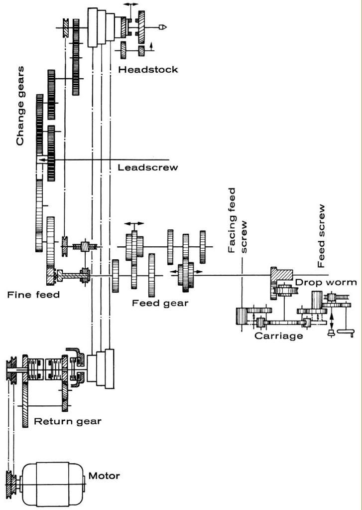

                            Originally posted by Arthur.Marks
                            With such a hard stop, wouldn't it be likely the belts would be prone to jump out of position? Or is that another one of my misconceptions... (probably)
                            My Boley has the same drive train you describe and also has twin electric clutches and an electric brake on the "return gear", equivalent to your counter shaft. It is primarily used for threading (metric). It stops the chuck in a fraction of a revolution and then provides a 4 speed return of the carriage, all at the flick of a switch and without stopping the motor. No belt jumping involved.
