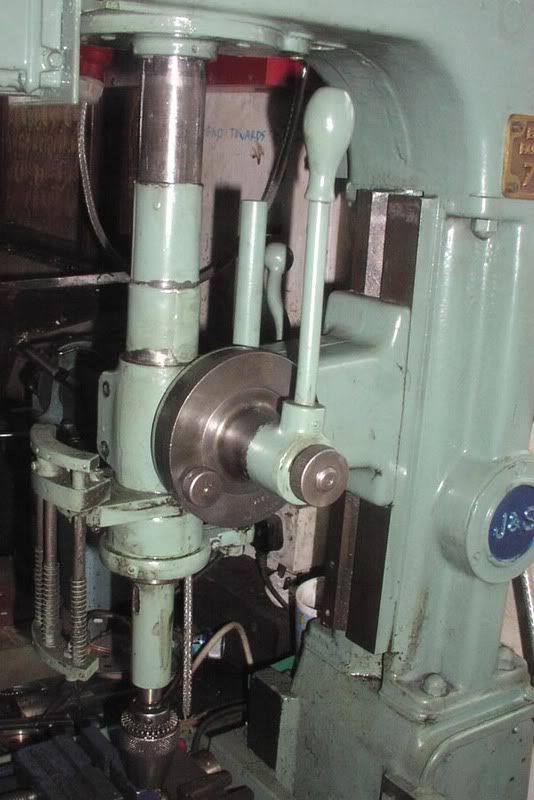

    btw ..on the quill at the side there will be a stud with a locknut on it .
    this takes up the slack ..but in practice ..you have to leave it loose or the quil gets tight at different positions in its travel ..so useless device.

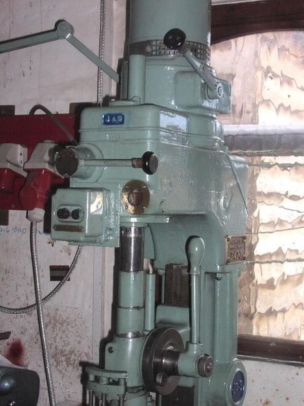

    here's what replaced mine ..best £100 i ever spent...table winds down so that there is two feet of clearence..rough cast finish was probably because it was a "war-finish" machine

          Originally posted by aboard_epsilon
          all the best.markj
          What operation are you doing with the upside down drill chuck?
          • #20
            epsilon,
            Now that's a drill press and quite a buy for 100 ponds.
                its just a weird drill chuck ..its like that ..it was built like that
                and awkward to use ....you have to put the bit into it before you put the thing into the mt2 quill...if i can remember right.
