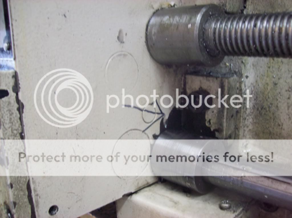

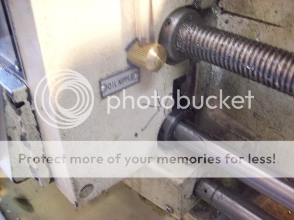

    Just a short intro. I am of the opinion oil is cheap compared to machines, hence I have replaced most of the ball oilers on my machines w/ cup oilers. I decided to change to some visible tube oilers on my Grizzly G4003G lathe. I had to take the cover off in order to drill & tap some holes and discovered there is a third oil hole under the cover with no way to oil it without removing the cover. I called Grizzly and got a call back confirming my discovery. The cover must be removed and ground or milled in order to have room to get an oil can in to lube the fitting. Removing this much metal opens up the space but creates a cavity that I am sure will collect swarf, that is the reason for the protective plate. The pictures should explain the entire process. Might take 2 posts for pictures.

        Holey crap!! I have had the 4003G for about 6 months and never knew an oil port was there. I just took the cover off and gave it a liberal oiling. Thanks for the tip, I will be milling that sucker out soon.
          how does the oil jump from the outside cover to the inside cover
          where exactly is the the oil hole your faciltating access to.

              Thanks for the heads up. I have the same lathe and will check that out. Is there a reason that cover couldn't be left off?? Also would it be possible to drill a hole in the cover and access the oil port that way?..I'm asking because I've developed a lazy streak..
              There is another oil point on the gear train side a lot of people aren't aware of. Have to take the cover off to access it. I solved it with a piece of brake line tubing and a small notch in the cover. I'll take a picture when it warms up a tad.

                Here's an oil port I've found a lot of folks are unaware of and my mod. Don't have to take the cover off to oil. Also found the oil port the OP posted about. I can get to it with a flexible spout. I will see if I can find a small tube and run it from the port outside the cover.

                  aboard epsilon: It does not jump, you slide the alum. piece back.
                  tlfamm: shop made
                  moe 1942: You could leave the cover off but I think if you do a lot of cutting that cavity will fill w/ swarf. I did the same tube trick for the oil port under the end cover when I first got the lathe.
                  When I called Grizzly they had a person go on the floor & remove the cover because I do not think they believed me, that there were 3 holes to oil
                    im not talking about the mod youve just done ..as far as i can see it jumps from the brass ones...the ones with "oil nipple" written under them .. to somewhere ...where i dont know .
                    all the best.markj
                      There is a protrusion on the inside of the cover that mates w/ the holes in the gearbox. Sorry I misunderstood your question. If you have a G4003 and remove the cover all will be revealed.

                          According to the manual at Grizzly the early model G4003 didn't have that cover. Then they extended the length of the spindle/headstock and added the cover as filler.
