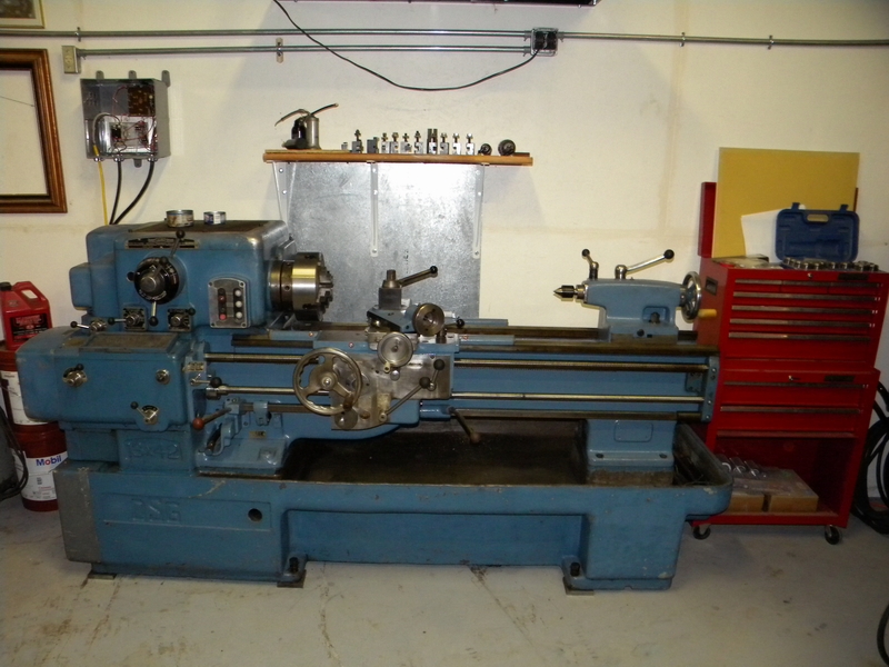

What to put behind the lathe?
  • #16
    I have a piece of 3/8 thick corrugated plastic board running from the back of the lathe over to the wall, then up the wall. The horizontal part is a bit lower than the surface of the stand, so whatever swarf etc collects there can be swept out past the tailstock end and into a box or bucket. That helps me keep the area cleared. The plastic can be wiped easily, but I don't know how long it would stand up to a solvent wetted rag.
    The corrugated board you'd normally find is about 1/8 inch thick, called tenplast, or coroplast- probably called some other things as well. The 3/8 material I have was used as sign board, so a sign maker would probably have it or be able to get it. I got my supply fairly cheap (free) so I've been using it for these various purposes. It might be expensive to actually buy though-

        My South Bend has plexiglass mounted to the back and I saw a small SB on the internet some where that had a very nice looking backsplash made from aluminum tread plate.
        • #19
          If you have shelving behind - an old pull-down projector screen will do it. I had one of those over the window in my first workshop, which was little more than a shed. Got rid of it when I built my current workshop coz I built it deliberately without windows.

                  Possibly some pieces of corrugated galvanized steel roofing standing on end, with a tray at the bottom, would make a good backsplash. Those roofing pieces usually come in 2 foot wide sections, and you could simply overlap sections until you have the width you need. Similar corrugated roofing panels come in fiberglass and other plastic materials, and would be easier to cut. They may also be available in aluminum , especially if you can find someone who dismantles old mobile homes.
                  • #24
                    My lathe came with a pretty nice idea - piece of sheet metal about 18 inches wide attached 6 inches behind and to the back of the carriage, bottom angled down so chips fall in the chip tray. The sheild moves with the carriage and keeps most of the mess under control.

                      As to the OPs question, I would recommend either moving the lathe out from the wall or simply screwing some plywood to the wall. Whatever you do, you want it to be replaceable for when (not if) something gets tossed at it at a rather high speed. IMHO drywall and other things "cosmetic" do not belong in a shop, period. If you want a showroom to display your toys, build one. If you want a garage, build a garage. If you want a shop, especially if you do much welding/cutting, build a proper shop.

                        I find a piece of tin by the headstock will catch most of the spray.
                        Easy to clean too.
                        Guaranteed not to rust, bust, collect dust, bend, chip, crack or peel
