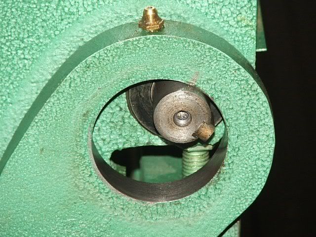

    The next two pictures show the stock cut/brake arm at the upper connection and the stock cam used with the crank arm. The crank had to go!

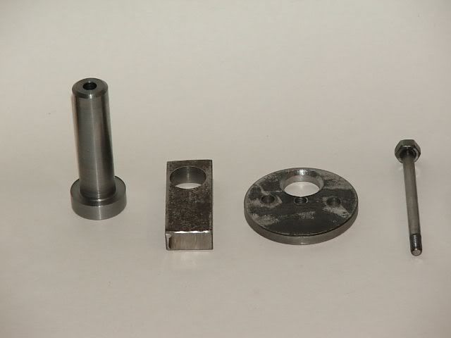

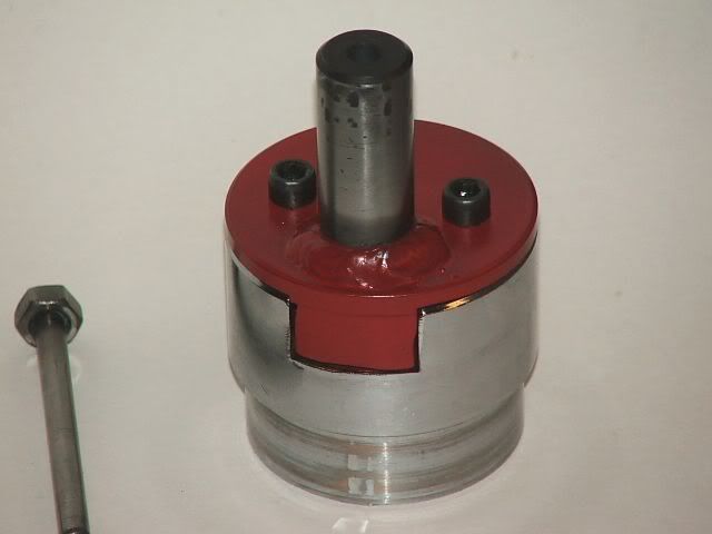

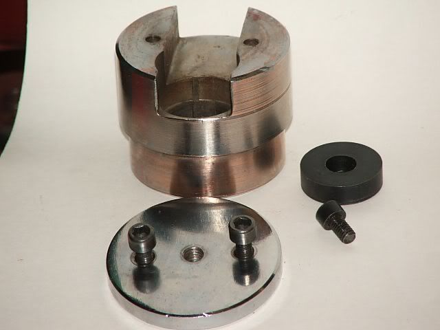

      These two pictures show the parts I fabricated to replace the crank arm and allow for powering the machine. It's really just a spud to allow mounting of a sprocket. The parts were duplicated for each side. The original cams were retained.

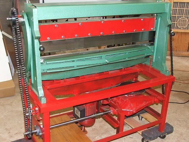

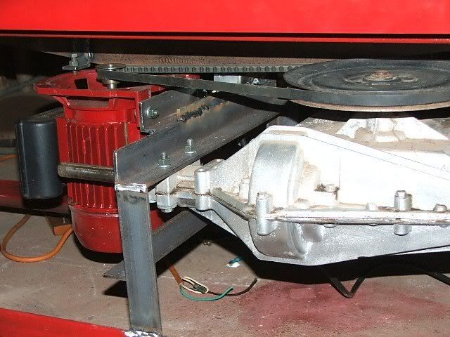

      The last picture shows the mounting of the motor and transmission. Earlier, I stated it was a four speed. It's actually a five speed. I use reverse for cutting and braking to keep the chain tension force off the idler sprocket. I use the other speeds for rolling.
