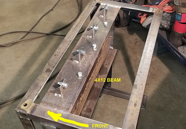

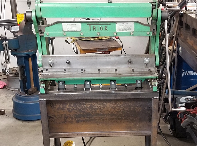

                        I made one of the OP's 3-in-1 stands. Like him, I used a piece of I-beam (actually W beam). But I left my beam intact for stiffness. Installed and adjusted, the shear cuts very nicely now compared to before. I haven't painted mine yet, will do that when the weather improves. I added a couple pictures below. The guards and table aren't on the machine. - metalmagpie
                        • #27
