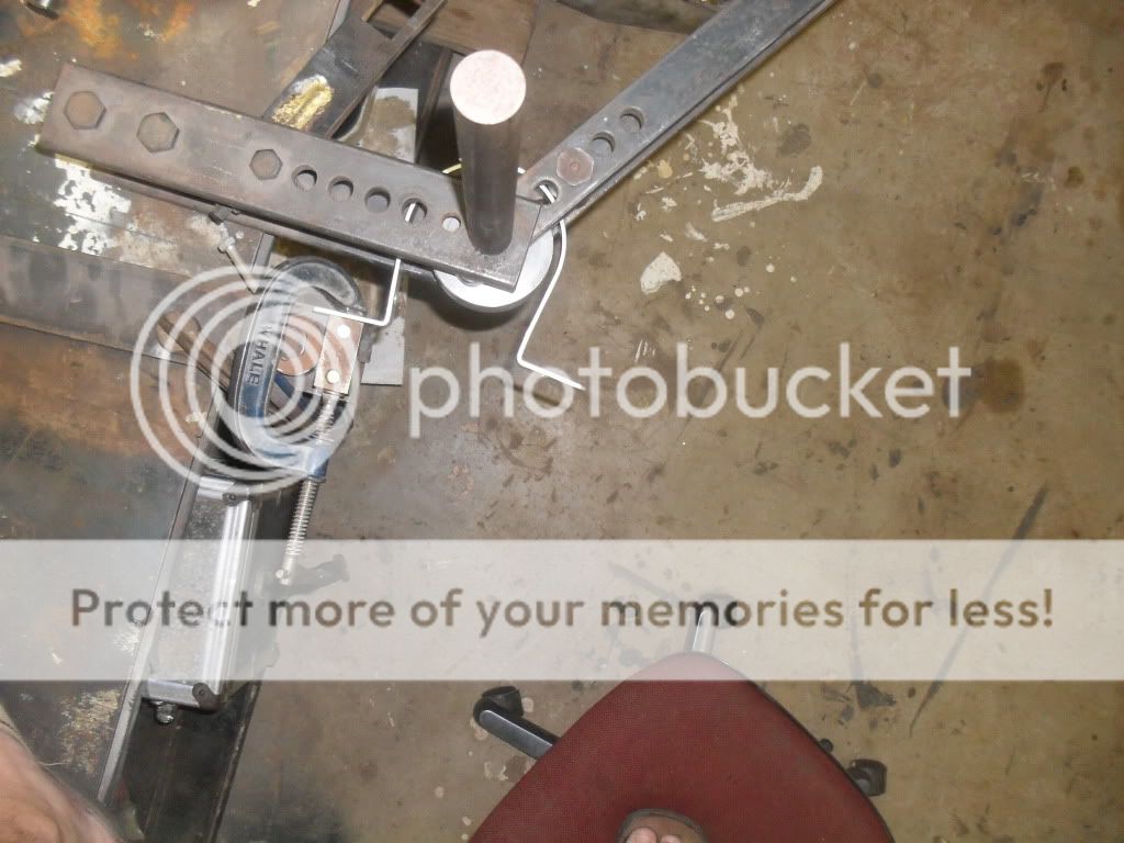

    I need to make 400 brackets to hold the absestos gutters in a complex. I was hoping someone could put me in the right direction as to how to make this. I made a 87mm die to bend the bracket. The pipe is 90mm . Is there a formula to know how to make the die .I seem to get alot of springback and land up with a bracket of 110mm.Is this maybe a bad way to try to make this bracket
    A block of wood cut out in a band-saw . Use in a hydraulic press. You will have a male and female form, which will easily do 400 pieces. First bend your 90 degree tabs, insert in die and press. Adjust as necessary. This kinda assumes a press and band-saw! Love the shop flip-flops!

        These are old absestos downpipes.I wanted to make them out of aluminium 25x3mm flat bar. I was unsure of making them out of stainless because its so dam hard to drill.Also isnt it hard to paint .I am worried that the aluminium will corrode especially at the drilled holes.I was told aqnodising would not make much difference.I live in s africa so unfortunately there is no master mcCarr in my country.Millwrong I dont own a band saw or a press Just a 4x6 bandsaw and a 3ton arbor press. Could I use that?

                I think the 90 bends are the hard part..... that and cutting strips if you have to do that.
                The round part can either be formed as and where used, OR pre-formed over a wood form.
                I suspect that minimal tooling is the key.... I'd be tempted to form over a piece of pipe.....maybe by hand... Thin aluminum would form OK, and if you establish the proper overbend, you can put a block to stop the bend.
                An afternoon of boring work and they are all bent.

                  Having an exact die dimension is not that important, I would just work to a fixed length of strap as it's not so much the formed size but the installed size that matters.
                  The length of strap you will need is (2 x r) + (∏ x r) plus whatever size you want on either side of the right angle bends.
                  ie (2 x 45) + (3.14 x 45) = 231.4 mm + say 50 mm for each of the right angle bends.
                  I would accurately mark and bend the right angles first and then form the curve using your die. If you bend around using your existing die it won't matter if the curve is not exact as they can be bent or opened up the extra bit on installation.
                  I would make a couple first and see how snugly they fit a real pipe and then adjust the length of strap accordingly.
