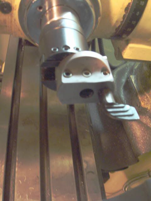

    this thing (ZF-6 ford f-450) was just a half inch too tall to fit conventional so I had to throw the head down on the hoe and tram her all up
    Here's a pick of my extension bit for my boring head - it's actually one of those trailer hitch pins I found on a bike ride - I milled it and ground it and put a flat on it were the allen holds it so it wont rotate in the head --- went to use it and it would not even touch the case material - said "oh crap I hope it's got some carbon to it" re-sharpen - heat it up cherry red and dunked it in some dirty dishes in the kitchen sink
    Lucky for me it had some carbon to it :-)
    Score one for the hillbillies
    Now I gotta make a dang sleeve...

    nuther pic of the bit, kinda proud of my trailer hitch bit

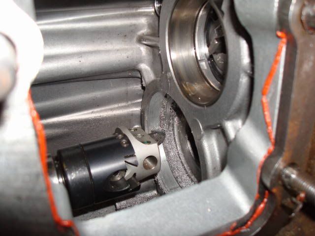

    The PTO access was ideal for keeping an eye on things and adjusting the boring head.

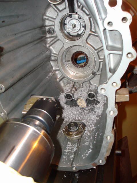

    A prophylactic and a rubber band was the ideal choice for keeping the chips from getting into the sump screen ---- put a helmet on that soldier!
      That tool looks like it did a real nice job.
      How'd you end up tramming this set up?

            Nice job on the case! I've rebuilt a couple ZF trans in my day, they are a pretty darn bulletproof trans. The one in my 89 F250 took a beating and worked perfectly up till the day I took the truck to the scrap yard with over 300K on the clock. That was 200K work miles and 100K of high school and stupid kid years of a beating. The truck saw the river more than the road.

                Hey thanks all,
                Jim - I use my mill as a lathe all the time so already have the head aligned (fore and aft) to the table cuz it's a turret mill and adjustable that way,
                as far as being level parallel I just stick the quill out full 5" extension and mild lock then attach my magnetic depth indicator to the table and measure at the highest point of the quill and run with it, I always double check the other first though to make sure nothings changed over the years...
                When u hit the peak of the quill on each test and BOTH hold the same reading for the entire 5" of X axis of mill table travel you know your good to go...
