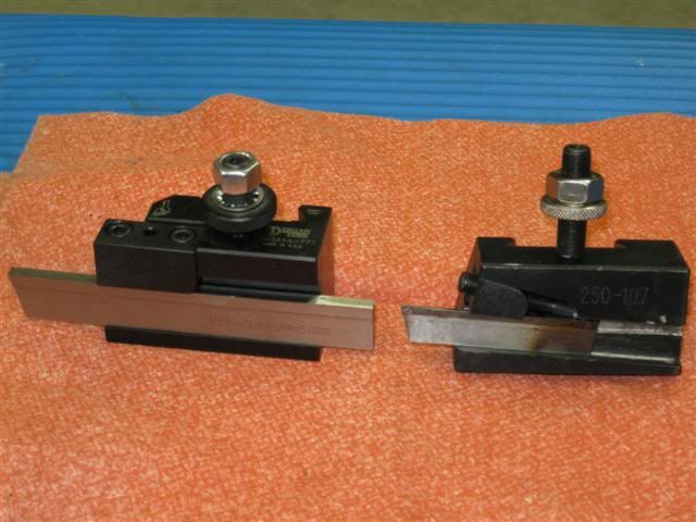

    After asking the question about rake angles on threading tools, Similar questions arise with parting tools. These parting tools illustrate the differences.
    The larger cutoff blank has a rounded like groove down the middle. Gadgetbuilder posted some instructions for grinding a similar groove to control the chip. There has been some discussion of a cross groove behind the tip that sort of establishes some back rake and rolls the chip into a small clock spring slug. Your thoughts and experience with HSS parting tools are solicited.

    The groove in the top of the blade causes the chip to fold in the center. That helps prevents the chip from becoming wedged between the blade and the work piece. Gary P. Hansen

        Your tool holder on the right has back rake built in, can't tell about the one on the left. It looks like you've grooved the right holder so the T blade sits perpendicular, as it should.
        Some books advocate grinding back rake into the parting tool, possibly for holders that don't have the back rake built in. The reason back rake is built in is to allow sharpening by grinding only the front edge. When back rake is ground into the top of the parting tool, after sharpening the front a couple times you need to grind a deeper groove in the top, then after doing that a few times you're below the top of the T and you must grind that section off and start over. Takes time and uses the blade up much faster.
        The T shape blades I have include side clearance so I sharpen the blade without removing it from the holder. Just set the table on the grinder to 7 degrees, put the holder on the table and touch it to the wheel. It is very quick to do so it gets sharpened often but little is ground away on each sharpening. Sharpening leaves a little burr on the sides so a touch is needed with a slip stone to remove that. I grind the little V you mentioned in the top of the blade (with a Dremel) for 1/8" or so back from the tip so this needs to be refreshed occasionally when it gets ground away.
        The V causes the chip to have a bump in the center plus the edges are wrinkled looking and are fragile. Chips generally exit the slot as an irregular curl or as short sections. In some materials the chip curls up straight and breaks off as little round coils. Since the V chip is narrower than the slot the swarf exits easily.
