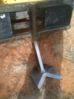

            Around here, we have to deal with mesquite trees. If we can get to them while they are small, we have been having good luck with the grubber in the picture. I use this on a NH LS170. For mesquite you need to get the cutter plate about 6-8" below grade in order to pull the tree out root and all. Our local New Holland dealer makes these in their shop and sells them for about $1300.00. There is not much too it, I think a fella could build one without too much trouble. Most of the metal is 1.5" mild steel, the mounting plate was purchased from a vendor. I have seen these plates for $150.00 or so on the internet.

                      I think I was typing as you were posting! An interesting idea you have there. A piece of plate steel with the right "hole" cut in just may work! Do you think the sapling would bend and slip through?
                      Can you explain how the grubber you posted is used?

                              With the grubber, I stick the cutting plate in the dirt about a foot prior to getting to the tree so that the cutting plate engages the tree about 6-8 inches or more below the ground. Then (with the loader arms fully lowered) I move the skid loader forward and simultaneously rock the grubber back lifting the tree out of the ground. Most of the time it lifts the roots out of the ground (talking mesquite here) occasionally it just cuts the tree off below grade. Either way if it's rooted out or cut off 6-8" below grade it is not likely to grow back.
                              By the way, I was able to rent the grubber from a local equipment place for about $40.00/day or $60.00/wk. We rented one for a week, liked it so much that we just bought one. We have about 600 acres to control mesquites on.
                              Sorry, my description of how I use this thing is probably clear as mud, If you have any questions, please ask.
