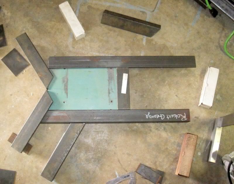

    Like everyone else here, I'm continually trying to squeeze 10 lbs of machine shop into a 5lb bag. I've got a bunch of grinders and buffers, and not nearly enough space for pedestals for each of them.

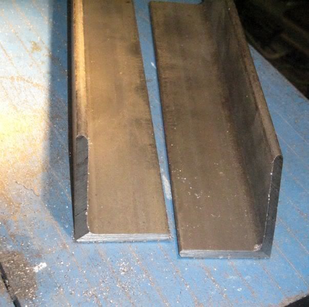

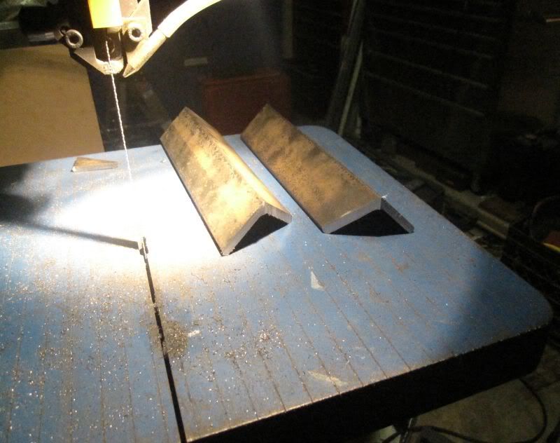

    I saw a similar design on Garage Journal, here's my version, built around a Burr King grinder pedestal. 2" x 1/4" angle iron:
    Mitre cuts at 120° and some quick trig calculations for the length:
    Weld in some gussets for the Baldor 500. The framing hammer is for the transfer punch -- honest!
      ...and 15 minutes later, it's done!

                          Very nice! Is the stand going to be bolted to the floor or are you doing a balancing act??

                            The question i have is could you have made the grinders rotate into position ?
                            Not being critical of your design ,just thinking of the floor space required to walk around to each machine.
