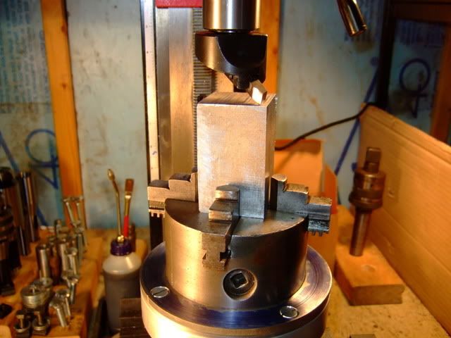

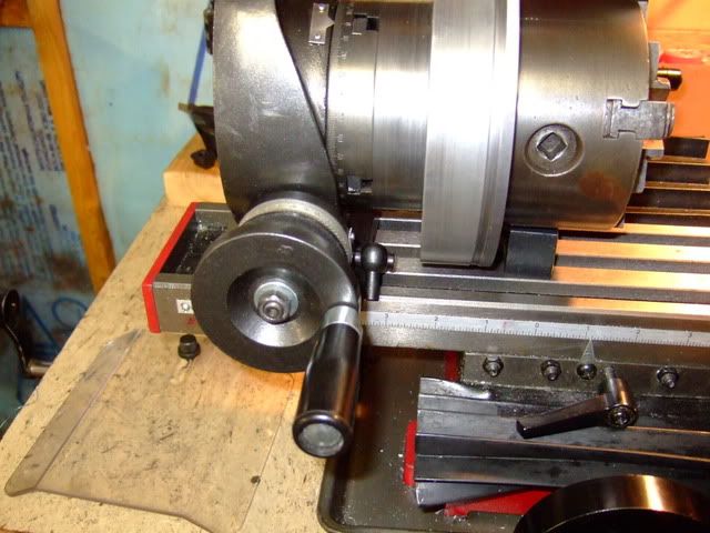

    I bought a 4" rotary table ,but in reallity needed a 6" to mount my small 4 jaw chuck. I made an adapter and extension to accomplish mounting the chuck.
    The 3 pieces of steel and Al are bolted and located with plugs in the center of the plates. Now the only thing I have to do to it because of the 4 jaw being universal is to regrind the ID of the the jaws because of a .012 run out in them. I have to cut a couple gears so I want it pretty close. I do have a question on putting a load on the jaws to grind them. Can I get away with using a machined circle of steel on the OD in order to grind the ID? What would be the best proceedure?
    [IMG]http://i750.photobucket.com/albums/xx142/Boot-010/DSCF0327.jpg
    Man, that is a lot hanging off that poor rotary table. Why so thick?
    Grinding the jaws may not help in the end with that. The wear could be all in the slides.
    I think I would just get a cheap chinese chuck, install that, and be done with it.
      +1 on what macona said. I would triple check where the slop really is, having been told by others that a particular chuck's jaws were out in the past when in fact it was a backing plate issue.
      I think rather than try to mate the chuck to the rotab, what I would do is simply make and mount a small face/fixturing plate to the rotab. Even if it hangs off one side more than the other it makes little difference, and keeping your part closer to the rotab itself will increase the rigidity tremendously.

          I'm with Jerry on this one - I can't fathom that base is rigid enough to handle that much leverage and not induce a taper.
            No, look at where he is clamping the piece in the chuck all sorts of daylight. Probably just a worn out chuck.
              Wow, went back and looked at that pic, there sure is a lot of daylight showing. ALSO, maybe its just me but that sure looks to be a 4 jaw chuck in that pic showing daylight, 2 of the jaws "appear" to be centered on the sides of that stock. Probably just a illusion.

                IMHO, when that rotary table is in "horizontal mode", seems like a lot of breakout force is going to be applied to the table T slots because of the excessive overhang combined with tool induced forces. Chuck too big, RT too small, clunky backplate/adapter setup.
