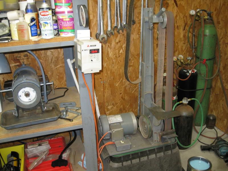

            The VFD for my belt sander is just wired to the shelf next to where it is used. Growing up in a time when hay was bailed with wire there was always an abundance of second hand wire.
            Actually I sometimes need to move the sander and this makes it easier.
