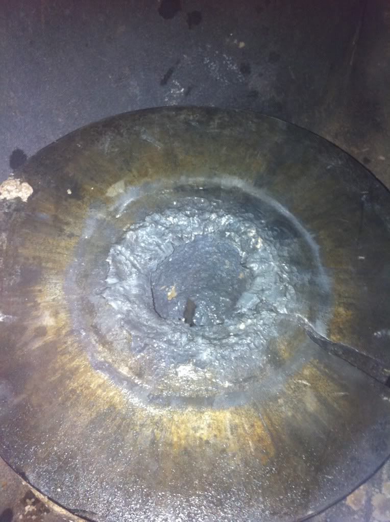

    Did a shot with the new aluminum cone. Its 5”base and 7” tall cones. We used sec80 pipe for the charge at 10” tall. The charge was 7# of our binary and we did not use a standoff ‘we wanted to establish a base line for the standoff. Target was 11”X 3” burnout of mystery metal and three other burnouts of 1 ½ “thick stacked underneath. Knocked the hell out of them the shot put them 18” in the ground. Strange it only penetrated the top 3” burnout and the next one was relatively untouched. A standoff will help penetrate the rest of the plats. It’s interesting to see the outer edge of the hole full of holes and dents. Shows wear the lower part of the cone didn’t have time to collapse and fit in the hole.The hole in the center is just over 2” wide. We also cracked the plate all the way threw on one side.

    ..............wow..............
      Your gonna clean that up with a boring bar right?
        I was thinking of cutting it in half with the band saw. Or at least trying; wonder how hard it is now. Think it work hardened any? It only got hit once.
          Please send 100# for further testing. I'm sure you need northern data to verify the results.
            Like to see what it can do with a proper stand off.Keep posting about it.Even if none of us will need this information...I hope

                          Interesting! Do you get the same penetration with an Aluminum cone as you would with a copper cone? Back in the day ( a long time ago) most of the Monroe effect munitions I saw used a copper cone. We did get a bunch of cratering charges at one time but I am not sure what they used for the penetrator.
                            The US Army had two cratering charges that I recall. The smaller, about 15 lbs I think, used a glass cone. It was supposed to produce a much cooler hole, so that a satchel charge could be added without waiting an hour or so for the slug to cool.
                            Loading a hot hole could be VERY career-limiting!
