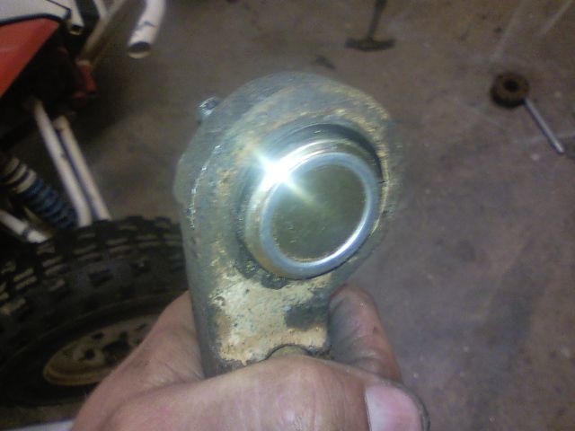

    Been playing with the lathe and mill for a few weeks now,learning it's kwirks,and finally decided to tackle a job that has been on my mind for some time....

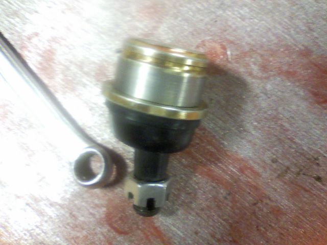

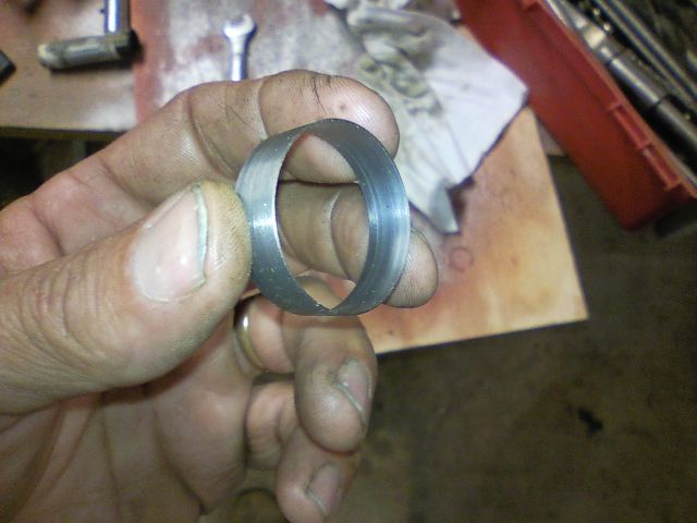

    I am an avid hobbiest of Honda Pilots (not the suv) made in 1989 and 90....There are parts becoming discontinued on a daily basis,one being the rear balljoint in the rear a-arm....I searched extensively for a replacement....I managed to find one with everything the same except for the outside dimension...The new joint is .014 smaller than the hole in the knuckle.....I made a shim bushing to take up the slack....Made the ID the exact same as the joint,and a .0075 wall thickness,giving me a .001press fit....Worked perfectly!!!!!! Here are some pics of my progress....

              I have to ask...what was the ball joint you used originally intended for and which parts guy did you have to schmooze in order to be able to go through his stock to verify fitment.

                  1/ You could make a bushing that Dia., that thin.
                  2/ There were 2 ball joints ever made, that close but not quite. Or is the Honda one metric and you replaced it with an American one?

                    Well,I have a mistake to admit....I originally posted after looking at my notes....After reading your post,I double checked myself...The joint is actually .0295" smaller than the original,not .015.....The .015 I had written down was wall thickness of the bushing....When I posted,I was thinking the exact same thing,that I couldn't believe I was able to machine that thin!!!!!! LOL.....It still worked great though!!!!!
                    The joint I used fits several models from trx's to kawasaki models as well...The original joint was pilot specific,and didn't even cross with other models in 89 and 90 while in production....I am in a close relationship with my local Honda dealer,so looking through his stuff is not a problem....I think the only other place I have spent more money in the last few years is my daughters college....
