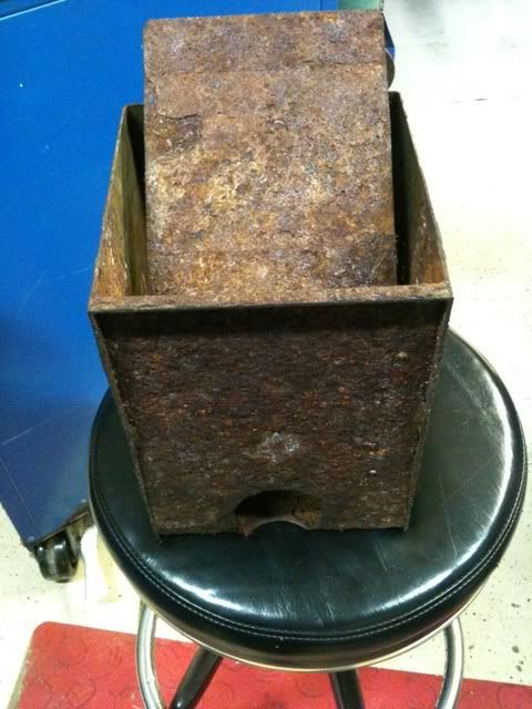

    My foot pedal for the Trinco Media Blaster froze up. No surprise, it was pretty rusted. Since I'm in the process of moving equipment around the garage the blaster was out of commission. Looks like it's time to try electrolysis.
    In the beginning:
    It was very ugly:

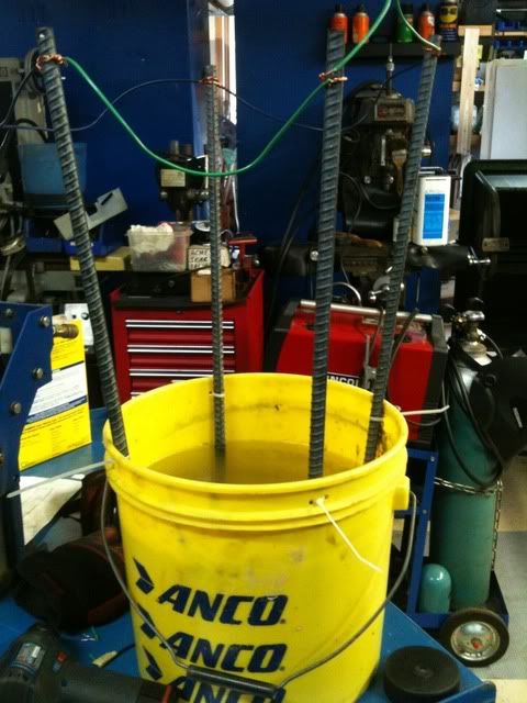

    The 5 gal bucket with 4 gals of water and 4 Tbls of washing soda. 4 sticks of rebar with copper wire attached to each piece. Electrolysis, from what I've read is line of sight, who am I to argue.

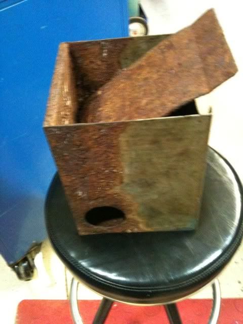

    after 24 hours: not so impressed. the light rust came off and was very smooth. the heavier rust probably needed another 24 hrs. too bad, since it wasn't fully submerged, I turned it over w/o adding add'l water of soda. and I didn't clean off the rebar.

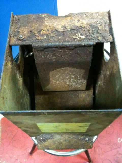

    this is > I turned over the pedal and another 24hrs in the nasty gunk. still pretty bad, but at least all the hinges now work. So I took it out, sprayed it down, and ran a grinder over it.
    hmmm, not too bad, just a light grinding.

      1) I need a bigger bucket
      2) when there is rust inside of a part, rig up some rebar on the outside and the inside)
      3) clean the rebar, change water, add more soda after 12 hours (especially on heavily rusted parts)

          1.) Yup, works best when the entire part is submerged.
          2.) If the inside is narrow (ie passage, pipe, etc.) use a cloth wrapped around a piece of rebar of chain. The cloth will keep it from shorting out.
          3.) I leave the part in for anywhere from 3 days to 3 weeks depending. Each day, pull the rebar and the part in question. Scrape the crud off of the rebar, wash off the parts (rinse with garden hose), submerge again. If you remember to clean everything every 12-24 hours, it doesn't take too long. I usually forget...that's why the "up to 3 weeks" part mentioned above!!

            You can cover an electrode in plastic window screen material and place it inside an item to derust its interior.
            Shoot! Andrew D beat me to it.
              Maybe more power.I was using my 6 amp battery charger and found 6/12/24 volt charger with higher amp output and I have had plane bodies warm enough the water was starting to steam.

                            Sounds to me like your electrolysis cleanup is taking way too long. I suggest the process would be much faster with an appropriately larger piece of sacrificial metal for the anode than the rebar rods. I typically use worn out saw blades or scrap sheet metal. Think current density limits and you will understand the value of larger surface area. I use a cup per gallon of washing soda too. My tank usually runs at 14 volts and self limits at around 2 to 4 amps of current from my power supply. An hour or two would be plenty in such a setup, although I often pull it out early and wipe or scrape off any severe rust build up under running water and then put it in to finish.
