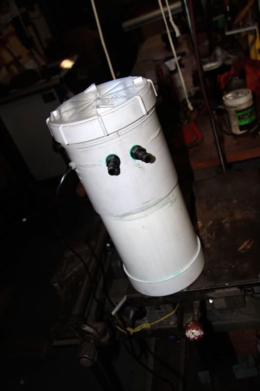

    I bought an old small metal cutting BS and have been slowly modifying/improving its operation.
    Blade cooling.
    Tank made from 6" PVC pipe holds 6.5 L of coolant
    A Small Aquarium pump drives the fluid around the circuit. Power for the pump comes from a socket from motor switch
    Mk II version of tank with fluid level window and click hose fittings for easy tank servicing.
    Coolant nozzles before and after the cut

        You might want to make sure the pump is off the bottom of the tank by several inches and there is a baffle to direct incoming water away from the pump. The rotor on those pumps is a pretty strong magnet and is exposed to the fluid. Magnetic particles and magnets in tight tolerances do not go well together.
          Pump sits on a 1/2" thick piece of plastic above the bottom of the tank.
          2 REE magnets are located next to the outlet of the gutter and there's one at the bottom of the tank.
          I have a similar setup on my lathe (except the pump is about 3 times more powerful) which has been running successfully for about 12 months.
          Very little metal is evident on the magnet inside the tank.

                        why do you cool after the cut?
                          Probably intended to wash chips from the blade before they're carried on around. Some larger saws have small rotating brushes for this duty.
                            dian the coolant after the cut is JUST in-case he put the blade on upside down
                            Some great ideas Bob, thanks for sharing.
                            Oregon Coast
                              i have scrapers on the blade after the cut.
