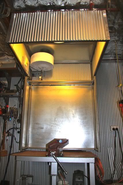

    I don't do a lot of welding but when I do I hate the fumes and the way everything in my shop gets coated in grey dust so one of the things I have been hankering for is a welding fume hood.
    The fan is a 230 W 500 cfm squirrel cage fan that was used to drive air through a HEPA filter in an acid distillation lab at work. It was quite corroded and being thrown away but it came up alright with a bit of TLC.
    The light fitting came from a kerbside rubbish collection except for the top which is a clothes dryer door.
    I will be adding some sides and front doors so that I can also use it as mini spray painting booth

        Bob,
        Did you actually try welding there already?
        When I started converting my garage to a shop, I experimented quite a bit with different aproaches to DIY fume extraction. Finally, I went with an exhaust similar to yours (pyramide-shaped 4' x 4' hood at the ceiling level (10') with a powerful traditional exhast motor installed through the roof and connected to the hood with a 1' dia. flexible duct. It works very quetly, but I cannot say that it's very efficient in terms of quick evacuation of fumes. Ideally, the hood should stay very close above the table. At least, right above the head level. Then the quickly raising hot fumes don't have any chance to spread out and escape evacuation. I was thinking about making a hood that may move up and down, but mechanics of it was just too cumbersome to my taste, so I desided to trade efficiency for a convenience and put my hood at the ceiling level.
        However, despite its somewhat limited efficiency and wasteful loss of heated air, my hood allows me to do some welding in the winter when opening the garage door is not an option.
        As for having such reflective walls surrounding the area where you're going to weld, just make sure you realize that using an auto darkening helmet may become problematic. This and a massive UV reflection would cause me to think about painting the reflective walls over. Also, I find it uncomfortable to have any light source above or behind my head when I'm welding: too much light goes underneath the mask.

          Not with the fan running
          My shop at that end is only 8'6 high and the hood is 16" high so the bottom of the hood is only 7'2" from the floor and 4'2" from the top of the table. I realise that this is too low for most people but most of the stuff I weld is small, that's one reason why I only have a 3 x 2 ' welding bench although the vice is on a 3 x 3" post and is easily removed.
          The other thing that I still have to add are a set of bi-folding doors which will completely surround the table and although one cannot obviously weld with them closed they can be partially closed (e.g. so all except the front is open which will help constrain the fumes. I also have a 3HP dust extractor in my shop which I have been using to evacuate the fumes but I don't want to use it continually as it clogs up my filter bags with welding dust and the only way to get them clean is to wash them. Also I plan to use the hood occasionally as a mini spray booth and paint is something one definitely does not want on filter bags (I've lost a set of bags doing this)
          If I was welding for long periods I would definitely take this into consideration but the amount of welding I do means the galv sheeting will probably loose it's shine very quickly especially when I start using it as a spray booth. The bifolding doors will be made from Dexion shelving and are already painted.
          I have actually found the reverse. my helmet curves right around my head and finally now I can better see what I'm doing.

            Makes sense.
            And having a hood 4' above the table will, definitely, work quite well.
            Good luck to you with your shop. As far as I understand, the lonely towel is already a thing of the past.

              A suspended "bath/shower screen" welding curtain will do a lot of good.
              Air extraction may be better if the nozzle is located closer to the welding pool.
