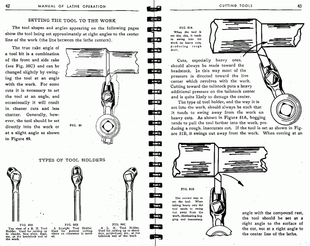

    The Atlas Manual of Lathe Operation is adamant that the tool should be set at such an angle so that it cannot swing into the work under heavy cuts. With the slender lantern toolpost the tool is in line with the toolpost pivot and this is easy to do as illustrated in the Atlas Manual pages shown below, but how do you follow these guidelines with a QC toolpost. With a QC toolpost if you have the tool at rightangles (or angled slightly back) from the workpiece it is still offset to the left of the pivot point and can still swing into the work. If the tool is suitably ground to be set at an angle such that the point of contact with the work is in line with the toolpost pivot then the corner of the toolpost is angled too close in to the the chuck and headstock.
    Am I missing something?

        Thanks for the post and those pics Paul A. but I have two questions.
        When you say "I generally work with the tool bit perpendicular to the work axis so if it flexes it will rotate away and not dig in." - the tool although at rightangles to the work is still situated to the LEFT of the toolpost pivot and any flex will rotate the tool INTO the work as I see it.
        Secondly with all this talk about rigidity is there any point in using a run of the mill QC toolpost on an 10" or 12" Atlas for straight turning considering the above issues - won't the lantern be better?

              I think the advice in the Atlas manual just addresses (and underscores) one of the weaknesses inherent in lantern tool holders.
              Just look at the surface area clamping to the compound visa-vee the QC tool post and a lantern tool post, also the mass of each. The lantern has a ring, a rocker, an HSS piece of tooling, and a small bolt; add all those movable components together and the whole is more flexible than the sum of the parts.

                  Many have the misconception that a QCTP is always more rigid than a lantern, when in fact it depends upon the toolposts and holders youre comparing themselves. When comparing a similar diameter lantern to a QCTP with a post of similar diameter, I would in fact say that the lantern is very likely to be more rigid. Having a big block of QC steel is not important, its the stickout (distance) of the toolbit from the post that affects the strength of the post, not the total surface area of the base bottom (similarly, flange width on an I beam isnt necessarily important, but the web size is very much so). Also of important consideration are the parts of the post at or above toolbit level - joints that can flex, which a QCTP has several more of.
                  I have a small collection of lantern tool posts from tiny up to those accepting a 1" bit, as well as AXA and BXA mixture of Aloris and Dorian. I used to use the QCTPs pretty exclusively until I worked in a prototype shop. Now, the most frequently used tool posts for me are the lanterns, as they are the most versatile, and ~30% of the turning I have done would not be possible with a QCTP. Speed wise, I can change a toolbit out of a lantern just as quick as a QCTP, not that time is of much consequence in a hobby shop anyway. If I had to have only one, it would be a lantern hands down.
                  As to the original point, it is a simple safety consideration to never have a tool bit that will dig into the work should it flex or rotate, and this is an important consideration for either style of tool post. This is the reason why we have right and left handed turning tools, to prevent the tool bit from becoming a bullet lodged in your chest as has happened to others in the past. A lathe is rather forgiving in many of these situations, but a shaper is not and will snap a bit like a pretzel given the opportunity.
