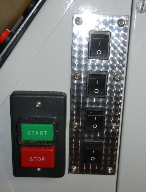

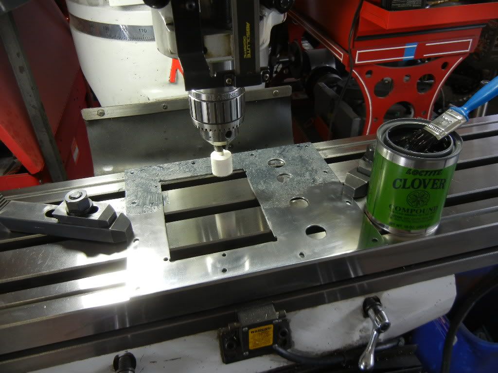

    Thought you gents might find this useful especially if you have never tried this before. I am rebuilding a Harig Surface Grinder and needed to rewire and reswitch the electrics. Thought it would be a good time to spiff it up some. Here's the process:
    Tools:

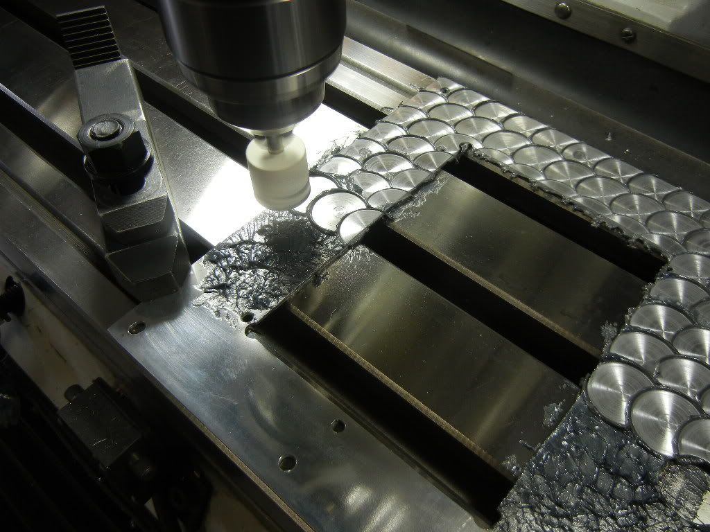

    Mill or Drill-press running at ~1000 RPM touch time about three seconds (light touch)
    Cotton Buffing Bob of desired diameter
    Clover Lapping Compound (shown is results on steel and aluminum using 280 grit (fine))
    Paint brush
    Lots of time and patience
    DRO is certainly useful if using a drill press graph paper is a good alternative

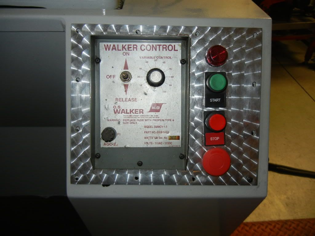

    Here are the results:
    Spiffy!
    Adds that nice finishing touch.
    Finest regards,
    doug
