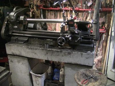

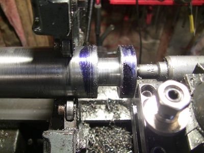

    This week I have been turning a couple 2" by 24" steel and getting chatter that would not quite. I tried everything I could think of from live/dead centers, different speeds/feeds, trying every shape hss and carbide I could grind up(including different tool radius). Had half the piece wrapped in rubber. I finally pulled out the steady from the draw and set up near the tail a couple inches from dead center... no more chatter. I read Forrest the other day commenting on the merits of owning several steady's... I agree. I will be searching for another now.

      I'm curious as to why you are not turning that groove up near the chuck near the head-stock as that would be the optimum solution - and the steady might not be needed at all - unless there is a good reason not to.
        judging from the pix you don't have one at all. The pix show a "follower" rest, not a steady. No wonder you have problems. Get a steady rest and experiment with it.
          A follower rest that clamps to the ways 2" to the left of the cutter? What does it follow?
            That is an open face steady rest with three rollers.
              In the pix I cannot see it clamped to the ways. It appears to be attached to the crossslide. If chatter is the problem it would be vastly more effective half way between the tool and headstock center.
                It is clamped to the bed but the 'ears' of the saddle go round it giving the impression it's on the saddle.
                It's nowhere near the cross slide, any form of steady mounted to the cross slide would be useless.
                  Thought I would groove while down there facing off but I wasn't really thinking clear. Your right Tiffie, should have been cutting groove at other end. I like the idea of running reverse but I've got those damn threads on spindle.
                  As noted the steady is just tucked in. I have a follow rest though, I will pull that out the draw too. Thanks for the comments guys!
