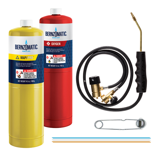

    I just came across a small medical O2 bottle with it's regulator, and was wondering if it was safe to hook it up to the hose of a bernz-o-matic oxy torch I've had for years, but never use because the O2 is so freaking expensive. I've rarely used a real oxy-acetelene rig, I used to use this unit for occasional brazing, and would like to be able to do more delicate work than stick or mig spool gun setups I have. Would this need flashback arrestors or any other safety gear? Is it just a poor idea? I don't need this desperately or I would have gotten a proper rig by now.

      The small medical O2 bottles I'm used to using wouldn't be able to be used on a torch set of any kind. Do you have a photo of it?

        The Bernz-o-matic oxy uses a MAPP can and a similar sized can of oxy.
        I didn't realize there was a big price difference in filling the tanks, it's still got to be way cheaper that the $9 they charge for that little Bernz-o-matic can with 1.4 Oz in it. I don't suppose I can just get this tank filled with regular O2 and promise not to breath it?

            This is the type of portable medical O2 tank I'm familar with http://www.galls.com/style-RO847-gen...-d-o2-cylinder. And this is a regulator http://www.galls.com/style-RO1059-ge...lator-with-2-d.
            Not going to fit a a torch set. And yes, medical O2 is considered a drug and requires a prescription.

              Yes also, medical O2 requires a prescription and is very expensive just because they can get away with it. The regulator on a medical gas bottle probably won't go high enough to supply that torch but I am not certain, yet. Medical O2 is supplied at extremely low pressure and the regulators are rated in litres per minute from 1 to around 10 max. I will be fiddling around with my concentrators maybe tomorrow and I have the same little welding kit so I will be able to say what works.
              No, you cannot get that medical tank refilled with welding gas. It is illegal.
