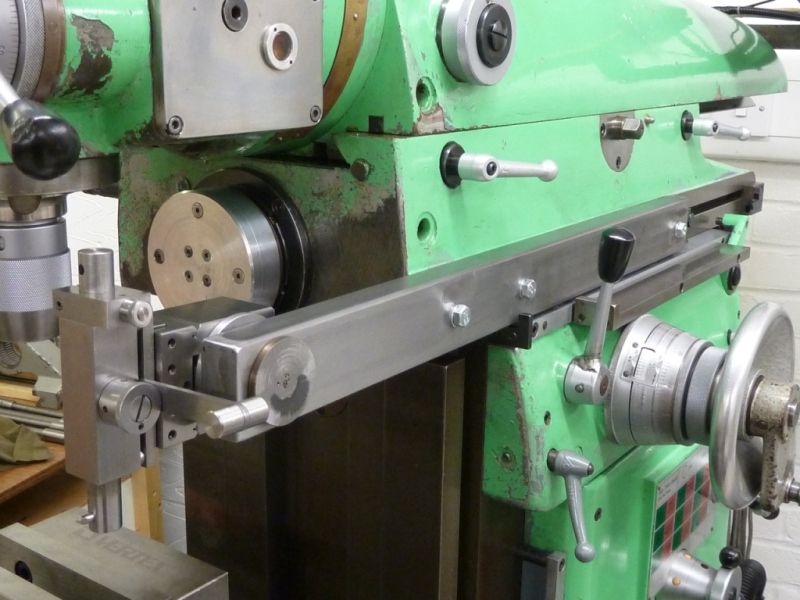

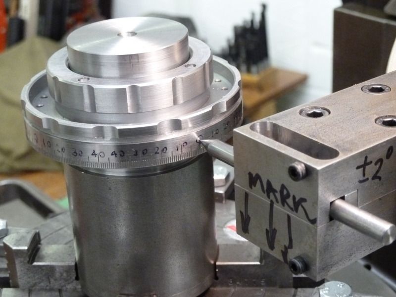

                      I am working on a project that requires a large number of graduated and numbered dials, collars and plates. I'd like to be able to say that there is a method of using number stamps that will give you as good results as proper engraving, but that isn't really the case, for me anyway. But you can get an acceptable result with a lot of care. Mike Burdick's PDF above, shows some really good numbering. I don't think my examples are quite up to that standard but anyway, this may give you some ideas.
                      1) Problems with stamps. I bought what I expected to be good quality number stamps. Like many others I found that they were not quite as good as I had hoped. The square bodies vary a bit in size and the numbers are not in a consistent position with respect to the shanks. The best method for fixing this I got from a friend in Belgium, which is to use a surface grinder to get all the numbers in the same position with respect to a pair of shank datum faces. Then use a Geo Thomas type jig to guide the stamps. This is an ideal approach, but needs a surface grinder and some means of measuring the number offsets very accurately indeed. The human eye is very sensitive to misalignment, so you need to work to very close limits to fix the stamps. I don't have a surface grinder so I had to use a different method. I made up some test pieces where all the numbers were stamped using a guide to align the edges of the stamps and then measured the offsets of the numbers in X and Y. Write these down and keep them with the stamps. Then when you use the stamps with a jig, Dial in the required opposite +- offsets number by number to bring the stamps into line. Yes - PIA.
                      2) Graduation. Most of my dials need graduating and numbering, and I think that this is the typical case. So although the OP doesn't mention it I think it logically belongs here. I use two basic methods of graduation. When possible I use my lathe with a detent device on a gear train and a graduating tool in the toolpost. This is quick and easy to use. Some cases are easier with a rotary table on the mill. I have made a tool which holds my graduating tool in a quick change toolpost and bolts to a tee slot on the side of my mill. This slot was intended to hold dial gauges and be used with slip gauges for setting the top Y slide. This is nice and rigid and allows positioning with the mill DRO and rotab.
                      Graduation then just involves indexing around and remembering to mark correct lengths for 1s, 5s and 10s.
                      3) Numbering jig I use a Geo Thomas style holder for stamps and this can clamp to the same arm. It is necessary to locate the numbers in the correct positions with respect to the graduations. This needs angular and linear offsets. I find the best way to do this is with a scrap test piece, since it varies with the size of the part, number size etc. To establish the location I use an accurately machined pointer which fits the number jig hole tightly. This allows you to set the position for the right and left hand (assuming two digit numbering) accurately. Then apply the required offsets. In the photo below, you can see that the angular offset is 2 degrees, and I have written this on the jig so I don't forget. You can also see that I have written all the required numbers on the part so I don't make silly mistakes. This is very important for a part like the one shown which has complicated numbering and has several days work invested in it. Don't ask me why i think this is important
                      4) Stamping You need to hit some numbers harder than others to get the same depth of impression. An 8 for example, needs to be hit harder than a 1. Fortunately if you use a good jig for the stamps, you can get away with a second tap. The cumulative effect of many impacts to your part as you go around it can cause it to move. It is a good idea to check alignment periodically so that the last numbers stanped will look in alignment with the first. Again, don't ask how I discovered this little problem.
                      Don't hit the stamps too hard. That will displace too much metal in the general area and will show when the part is finished.
                      5) Finishing off The stamping will raise the metal around the numbers. The appearance can be improved by very lightly filing the surface in the lathe, then finishing with very fine wet and dry. Don't use abrasives instead of a file, it will round everything off and spoil it.

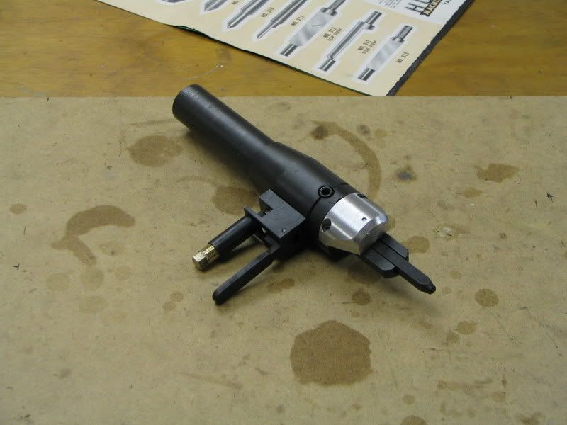

                            Stamping on that project that you have worked on for weeks and the results are disappointing ---- aaarg!
                            Lane showed me his solution, and I immediately thought it addressed most of the inherent problems with getting a good result stamping - and, its available to all of us, its in Vintage press "Metalworking Book 3" under the title "A Precision Metal Stamper" by Glenn Wilson. (Glenn did some good stuff!)
                            Heres a pic of it
                            Designed to fit into an R-8 spindle on the mill giving the benefit of using the X & Y tables to control the spacing. Having a spring loaded 'piston' to drive the stamp you can use the spindle crank handle to control the force of the imprint by raising or lowering the distance the stamp moves when you pull the trigger. With a bit of practice you can get quite good results - tho there is always a 'flyer' sometimes.
