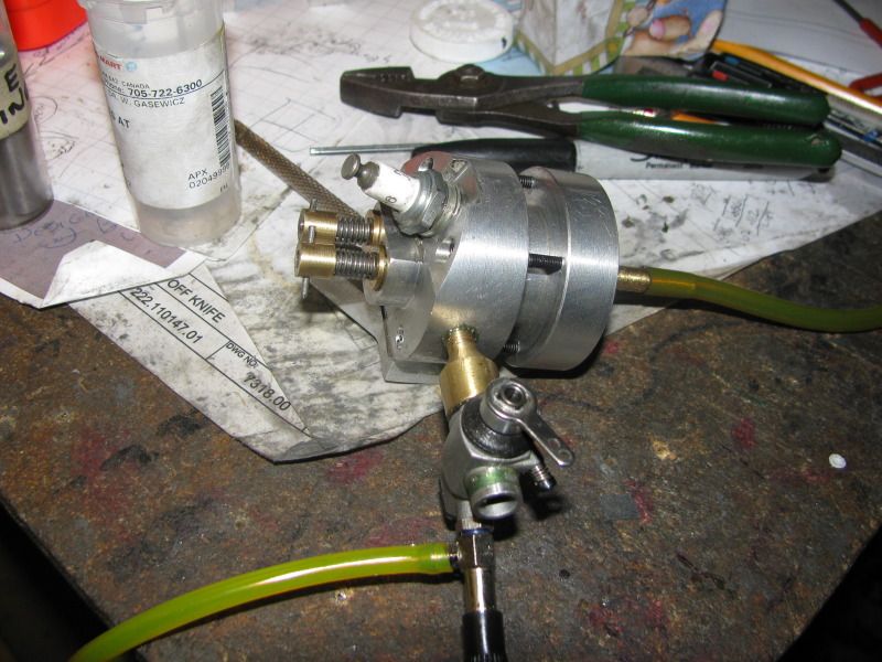

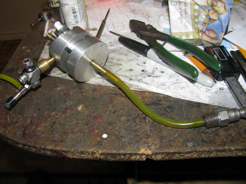

    It seems that in spite of all the care I took when machining and assembling my Atkinson engine, I have a leaky intake valve. Perhaps not leaking badly enough to prevent the engine from starting, but leaking, none the less. As I go through all the possible causes for the engine not starting and try to eliminate them, one thing popped up. Its a miserable chore to pull the head off the Atkinson once its all assembled, so I needed a way to test for leaking valves BEFORE assembling the head to the engine. So---I made a pressure chamber. This is simply a round peice of aluminum the same diameter as the cylinder, with the same bolt pattern as the cylinder, and an internal cavity which I can pump air into from my compressor. It is turned down to a diameter that fits into the recess in the cylinder head, and the internal chamber is big enough in diameter to miss the heads of the valves. I put a ring of gasket material between the test chamber and the cyl head, then carefully snugged down the 4 cylinder head bolts. Now I can pressurize the chamber with my compressor, and it immediately shows up a leaky valve. You can hear it hissing at the carb throat or the exhaust manifold. I am probably going to have to make a new intake valve cage ---maybe even a new valve. Ah well, bad on me. I thought that the pressure chamber idea might help some other poor sod who is attempting to build a 4 cycle engine.---Brian

          Brian, why not just inject compressed air at tdc of the compression stroke through the spark plug hole?
          it's called a leakdown test and regardless of how much is getting past your piston you can listen to the intake side and exhaust pipe for blow-bye...

            Blowby, the same reason many professional shops have a rig similar to the OP's for testing valves and injector sleeve sealing off engine. Its possible to have a pretty bad valve - seat seal yet not notice via the method youre describing.

                      This fixture allows him to work the next engine in-process rather than as a break-fix. I think he's looking forward to the next project more than worrying over the current one.

                              Not the way it works, you could easily hear 1/10 of 1% in a leakdown test coming from a valve - there's no mistaking it.
                              all that's needed is a heater hose placed up into the exhaust pipe or intake manifold with the throttle plate open and the other side to your ear, it should be dead quite - Iv ran hundreds of leakdowns,
                              they are so precise that if you ever do catch any noise you have to pop the valve cover and give the suspect valve (or valves) a quick tap with a small fiber mallet - generally 99% of the time the noise instantly goes away,
                              the reason being is this; ---- by simply removing the spark plugs you drop small pieces of carbon into the combustion chamber, the first tested cylinder usually ends up good if you start with the cylinder that already had it's valves closed - but it's the valves that were in the open state hanging down below the plugs level that will give you these results, as you rotate the engine by hand to do a test on these valves they will wedge the tiny particulates between the valve and the seat - now you pour the compressed air to it and as miniscule as these pieces of carbon are they will make the valve immediately sound bad no matter how little - a quick tap with a fiber mallet on the rocker arms end and walla - the sound is TOTALLY gone, and when I say TOTALLY GONE I mean ZERO blow bye..
                              if it's an engine that has a difficult valve cover to remove then you bring each cylinder up to tdc of the compression stroke and then remove it's plug, maybe harder to turn over by hand but you avoid dropping the carbon onto a valves sealing surface when its exposed...
                              It's impossible to have a "pretty bad valve" and not be able to hear it.
                              I am a professional shop and have worked in many - and none have had a separate "rig" for testing valves like your taking about - it would be totally impractical to remove a cylinder head just to test valves... there's also no reason to bench test them after machining and either prussion blue testing or lapping and verifying contact 360 degree's on both seat and valve.
