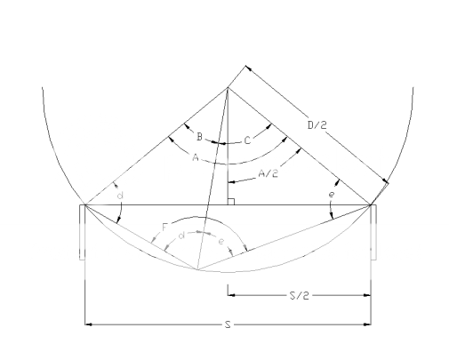

    Paul, a shortcut:-
    Given the two large triangles are isosceles (so angles 'd' and 'e' are mirrored) and that the three angles of a triangle add up to 180 :-
    B + 2d = 180
    C + 2e = 180
    Adding both sides of the above:-
    (B+C)+ 2(d+e) = 360
    i.e.
    A + 2F = 360
    F = 180 - A/2
    To calculate the required dimensions:-
    Where 'S' is the distance between supports, and 'D' is the circle diameter.
    A vertical dropped from the centre of the circle divides both angle A and distance S in half, giving:-
    sin(A/2) = (S/2)/(D/2) = S/D
    Now, from earlier, A/2 = 180 - F, so:-
    sin(180-F) = S/D
    (- and remembering sin(180-X) = sin(X))
    1: Given support distance and required diameter:-
    'Sled angle', F = 180 - arcsin(S/D)
    2: Given 'sled angle' and required diameter:-
    Support distance, S = D * sin(F)
    3: Given support distance and 'sled angle'
    Resulting diameter, D = S / sin(F)
    Cheers
