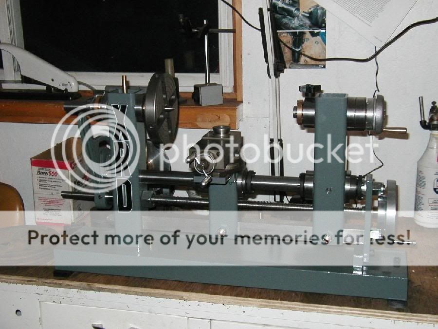

    I installed the lead screw today and the carriage runs back and forth smoothly. Some years ago I purchased a compound rest from Smithy for my homebuilt shaper. The shaper was recycled for parts after I got the Elliot so I have put the Smithy compound on this project to test it. If the lathe works to my satisfaction I intend to build a lower profile cross slide and compound. The Smithy compound will then become a milling attachment

        Way cool!!! Now, the acid test, how well does it work?

          Still lots of parts to make before I can try it.
          If it doesn't work it will make one hell-of-a paper weight.

              Still looking for a 3/4 hp motor. If I don't find one by the time that I get it ready to try I have a 1/2 hp that I can use.

                    It is made to cut up to 6" in dia. The actual swing is 10" over the bed rail. 10" between centers. MT # 1 in both the headstock and tailstock. 2-1/2" travel on the tailstock spindle.

                      It is from a 10" Atlas as is the lead screw.

                          eXe ReDesigned. Check out this link.
