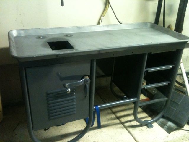

    I'm in the process of renovating my lathe. The tray is welded to the lathe table so I couldn't apply chrome. The whole table was sand blasted and then I spray painted all but the tray. I used a Dupont industrial epoxy paint in a dark grey.
    My question is whether the 'metal' colored paints can be applied and protected from swarf, cutting oil, etc. I wouldn't object to other colors like bronze, copper, brass as long as the finish is 'metal' like.
    Any ideas?

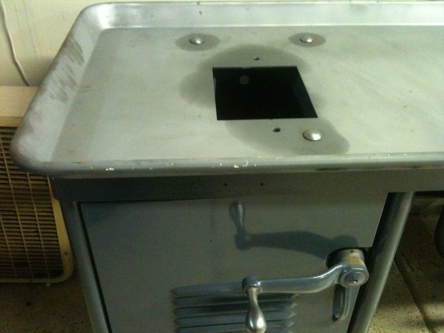

    I think you'd be better off with a surface that helps hide imperfections, such as a hammertone finish. If you could find a super-shiny chrome-like paint, it's going to show EVERY little nick and scratch and it's just not worth the effort in the abusive environment of a chip pan.
    A friend of mine is restoring a surface grinder and he painted parts of the castings with this "modified alkyd enamel" spray, in silver. It looks amazing. I would use an etching primer forst for best adhesion and wear resistance.
    http://www.rustoleum.com/CBGProduct.asp?pid=29
      I'm with PixMan on this. Chrome would look awful when it gets an oil film on it and smears If you drop something on it it will crack and peel and can cut the devil out of you when you are cleaning the chip pan. It's like a razor!
      Use a paint that will hide imperfections and dings, protect against rust, stands up to oils and doesn't chip easily when struck by an object. I've had good luck with Rustoleum's Professional Series paints. Preparation is the key for whatever paint you choose though. Super clean surface, lightly abraded, good primer and good finish coat. As for color, I'd choose something that shows up dropped tools easily while hiding greasy smears. It can be difficult to fins small dropped parts in a dark chip pan full of chips.
        POR15 is a very tough paint and would probably stand up to the rigors of a chip tray coating better than any other paint.
          Take a look into powder coating. Lots of different finishes, metallic,candy apple,flip-flop,pearl,wrinkle,etc.
          It's a baked on finish, so it should be pretty durable. You can also get ceramic coating that almost looks like electro plating.

              Duplicolor makes a chrome paint that looks amazingly like true chrome plating. You probably want to clear coat it with an automotive urethane for max durability. http://www.duplicolor.com/products/automotiveMetallic/

                    I used a chrome power coat for the silvery parts of my lathe, including the chip tray pan. It has taken a beating from parts falling and all sorts of no so nice hydrocarbons sitting on it and it still looks pretty good. You could easily take the top off and take it down and have it powder coated. Here is a pic of what the parts look like:

                        macona, of course it had to be a Monarch, where nothing looks bad. I do like the PC. but my top is welded on and I don't want that hassle. especially when I just got the drive in the lower cabinet.
                        now, a stainless steel liner. that's something I'll think about. thanks
